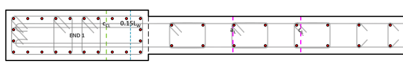

Considered Excel?
With the right VBA routines generating coordinates and some charts you can produce stuff thats not only to scale, but accounts for all the design/detailing requirements and virtually instantly reflects the actual design requirement with a visual representation so there are less miscommunications between design and drawings. Cut and paste it to an electronic markup in Bluebeam or similar and markup with notes.
Small example from a wall design spreadsheet I worked on demonstrating what can be achieved:-
Trenno, I've uploaded my Excel functions for generating the geometry of the stirrups and links to My github page.
While they are applicable for hooks in accordance with the NZ concrete code, they could easily be modified for any code really with little effort. But if all you are after is something that 'looks about right', then people may find them useful as is.
