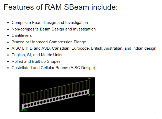

As for software for use on North American projects, RAM's S-Beam package handles castellated beams.
Thank you all for the recommendations! I have the AISC Design Guide,...I look into the software recommended. Ideally I design one by hand first using the guide, then select and use a program. As my mentors used to say,...and maybe everyone agrees with regards to computer results,..."Garbage in, Garbage out". So, I'll make sure I've got a handle on the design procedure and requirements first. Thanks again, All!
