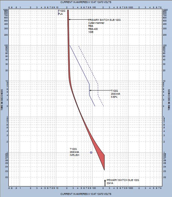

Below is a TCC for a 2500kVA, 12.47kV-480V Delta-Wye grounded transformer and it's 150E primary fuse. This is the existing installation. The full load amps on that transformer is about 116A. The recommended size per the literature I've read says to size the fuse between 100-150% of the FLA = 116A*1.5 = 174A....So the 150E looks ok.
It can be shown that the arc flash can be reduced on the secondary main if that fuse is reduced to a 100E fuse and the transformer will still start. But this is less than 100% of the full load amp rating. On the other hand, looking at the fuse curve for that - which is on the second post - it doesn't look like the 100E would ever trip even at 116A.
Would this be a good idea ?
There are a lot of considerations. The primary one - what is the actual peak demand on the transformer? If you don't know that, I don't think I would be comfortable going below transformer FLA. You really need to have a good handle on what the maximum possible load is on the transformer, even if it rarely occurs. Also, what is the magnitude of the reduction in arc-flash and is it worth it?
What multiplier are you using for the transformer inrush? The "inrush point" shown on the TCC is a very crude rule-of-thumb for avoiding nuisance tripping. The default in EasyPower is 8X FLA. I use 10X. You need to stay conservative with this constraint when fuses have to be replaced.
The 150E looks pretty good. The 100E looks to be cutting it a little too close. Maybe the arc-flash issue can be lived with, or it can be solved another way.

Thanks. I don’t see any real advantage in reducing this fuse, just an idea.
But I’ve seen this done successfully at a Plant I used to work at. As in they changed out the fuses 10 years ago to 80E on similar transformers and there’s not been any issues of those fuses tripping. And that facility switches feeders and transformer loading configs around more than most places.
I’ve another large company’s engineering standard that states that the inrush current on the transformer can only be determined by testing ... and if that hasn’t been done - use 12x as the multiplier. And that eliminates this idea too.
Reducing the fuse size only increases the risk expensive outages and total facility black outs.
While some S&C E rated fuses can be loaded above their rating indefinitely or for short periods of time, doing so shifts the fuse curve during said loading such that you may lose selective coordination.
Further inrush tolerance goes down. A quick trip and reclose just at the right point in the sine wave or voltage dip that causes motors to stall may cause nuisance blowing of the primary fuse.
All of this assumes overloading as indicated by the manufacturer.
Loading beyond recommendation can cause annealing of the fuse link. Annealing can greatly lower the current carrying capacity of the fuse such that a down stream fault or even normal load can trigger nuisance blowing.
You're asking the right questions and I applaud you for that, but also keep in mind there is a reason why those fuse curves start at 200-240% of their listed rating.
I'd recommend other alternatives to mitigate arc flash.

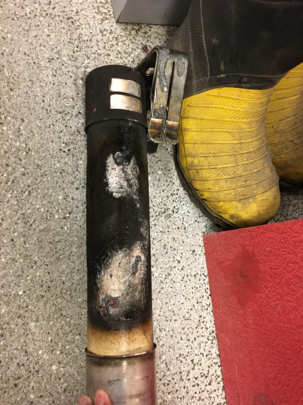

I believe these are both 5kV class E fuses, but you run the same risk of this happening if you under size a 15kV class E fuse. E rated fuses generally aren't full range fuses and don't react well to overloads in the 100% to 175% current range.
or
Geez. I thought these type of fuses are supposed to be self-protecting for any current up to the interrupting rating.
That doesn't look very self-protecting to me.

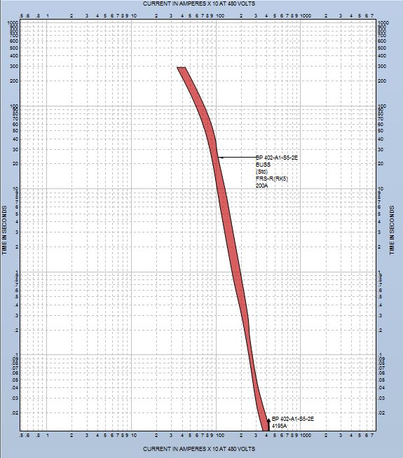

My point is that that this very common, 600V, fuse rated at 200 Amps ... the top of the curve stops at 350A at 5 minutes. In other words it has the same issue as the E-rated fuse, it's not much of an overcurrent device.
I did take a look at the cable it protects: 3/0...and that lies well to the right of the fuse. So it protects that wire so it's doing it's job. Maybe this is just the "conservative" approach the Code and Standard writers came up with in almost all installations, to make sure we don't screw it up ? just a theory.

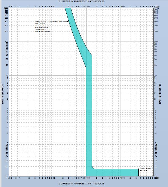

And if you look at this 200A, low voltage molded case circuit breaker's TCC curve with it's wide band at the same long times....it's practically the same as the fuse.
Table 310.15 B 16 and Table 310.16 are very conservative taking into account fuse/breaker pickups and then some. A 135% of more overload will not damage the conductor.
By starting at 125% instead of 101% assures that a breaker will not trip below 100% from ambient variants in temp, heat build up within the panel board, manufacturing tolerances, ect.
