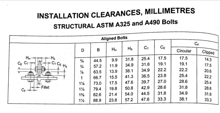

CISC has the following for installation clearances:
You take the worst case between tightening clearance and washer to fillet distance.
