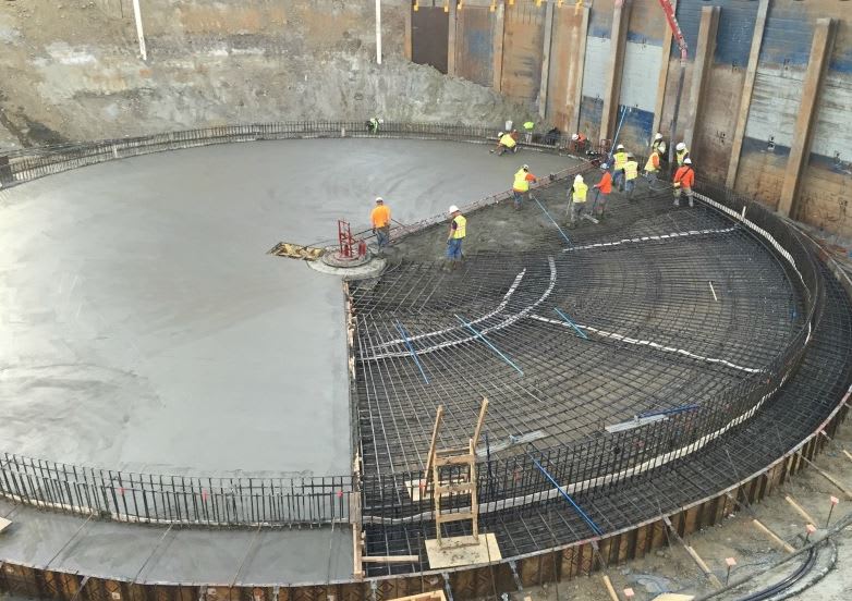

I've worked on clarifiers at wastewater plants which are very large round foundations. If you choose a round foundation, use a radial reinforcing pattern instead of a grid pattern if possible. The grid pattern will generate ALOT of different bar lengths which can slow construction and lead to misplaced bars.

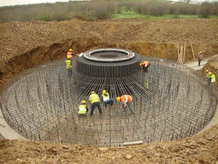

If you write WIND TURBINE FOUND. and search the web, one of the outcomes ;
The following doc. also provides some info.

1503: If you are sloping to a center drain then you are better off with circular rolled bars. Imagine doing a unique V bend for every bar then placing those unique bars in the field. Rodbusters would lose it.

And oh BTW please do not use radial bars, or bent into octagons. The drawing on page 30 in the reference I supplied shows criss cross bars in the mat. Do not confuse the finite element meshes shown in other diagrams as reinforcement placement directions.
The reinforcement in the image posted by GC_Hopi looks quite manageable if the tangential bars can be ordered straight and curved while tying the mat, ie if they're flexible enough compared the the radius. Then transition to XY reo at the centre when the radius is too tight and too many radial bar need to be terminated.
Octagon has straight forms but a little wasted reo in the variable lap lengths compared with radial-tangent reo.
