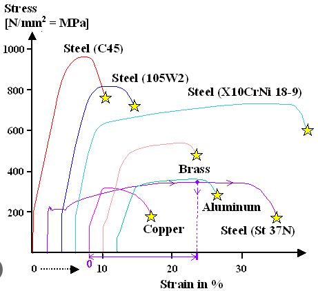

Doesn't brass and/or bronze have more brittle behavior than steel?
In general No, the Cu alloys will tolerate similar strain before failure.
Both groups of alloys have a huge range of properties, both strength and ductility.
The low yield strength of the bronze is likely to be the biggest issue that have to deal with.
And don't forget that Cu alloys have fairly high thermal expansion.
