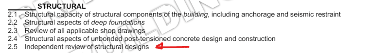

The new BCBC code also added a line to the schedules mandating the independent review is complete at the time of BP.
