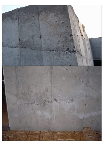

Perhaps it is regional terminology, but a cold joint to me implies that it happens during the same pour and is not intentional - previously placed concrete has become semi plastic and has fresh concrete placed against it due to some delay in the placement sequence. The situation described by the OP is a construction joint, which are planned and detailed for.
Dauwerda is correct. Examples of poorly prepared joints.
