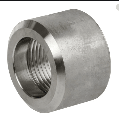

When I googled half coupling this is what I got
Now this is not an integrally reinforced branch fitting so I have no idea how you're going to weld a flat end piece to a round pipe, especially one 4" OD.
Did you actually mean a "threadolet"??
If you do do this do one at a time otherwise you won't have a lot of pipe left and it may end up rather bent...
