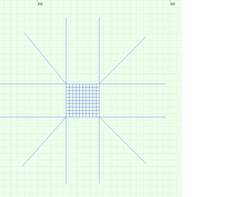

Thanks for the goals, so I think of this as a 2 stage effort. For reducing the touch and step voltages, creating a tighter mesh in your system makes less voltage difference on the earths surface. In some more extreme cases (like someone installing on rock ...like yourself) you may need to use a tight ground mesh like [URL unfurl="true"]https://www.erico.com/category.asp?category=R3138[/url]. A tight mesh may create step voltage issues around the edge, that you can mitigate with ground rods, or even making rods/ground conductor at greater depths (think of a pyramid with a flat top), so your ground potential rise doesn't have a steep drop off.
For the impedance, extending the footprint/area of your grounding system is the most efficient approach. You can look at the ground potential rise before and after adding the remote ground. You can try several runs of grounding extending from your grid like:
Regarding the animals, I don't think there is going to be a concise paper on that (like there is for determining human current thresholds). If you do find something please report back as I'd like to read that too! Looking at the step voltages you can determine if you are introducing more hazards to the area or if its reducing when you add your remote ground. Changing the buried depth lower can help avoid step potentials while reducing your system impedance too.
