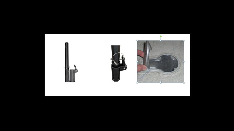

In order to show the concept,I write ( large umbrella removable base ) and searched the web..One of the outcomes,
Great solution...
I was thinking of some sort of bayonet style anchor to allow vertical restraint, but that looks as good as anything.

Removable anything will be some sort of compromise over a single solid tube, but many proprietary system exist like hturkats for removable posts.

HTURKAK: that seems like an interesting solution but, have you seen it used in structural applications? I know it's just an example but the one you proposed is for umbrellas. Or did you mean coming up with something similar myself and have the manufacturer fabricate it?

Yes for umbrellas but for big umbrella. I have seen similar concept at fair stands.. I just proposed to see the concept. If you cannot find a proprietary system, you may develop your solution with calculation and manufacture . It should not be big issue.
