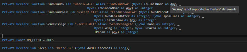

here i'm having a problem with As Any. It says that "As Any is not supported in declare statments".

1. Ok, then change the declarations to fit the usage (put whatever you want as long as you respect the type when calling the function:
Code:
Private Declare Function FindWindow Lib "user32.dll" Alias "FindWindowA" (ByVal lpClassName As String, _
                                                    ByVal lpWindowName As String) As Long
If you're using VS then change all "long" to "integer" and you should be fine.
