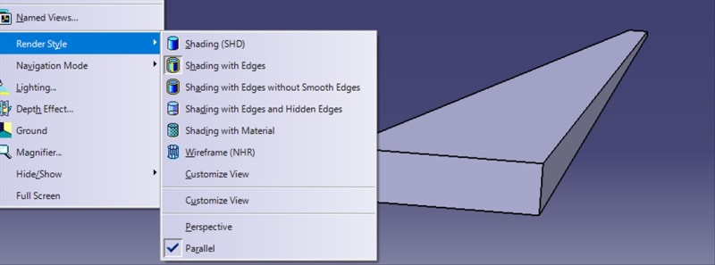

I noticed the same thing, that the view rendering type does change immediately on the screen.
But If I go to check Rendering Style, it still shows the previous mode until another command is activated.
I tried a few things to make it update, but couldn't find a solution.
As image below shows rectangular block in Perspective mode, but Catia indicates Parallel until another command is activated.
