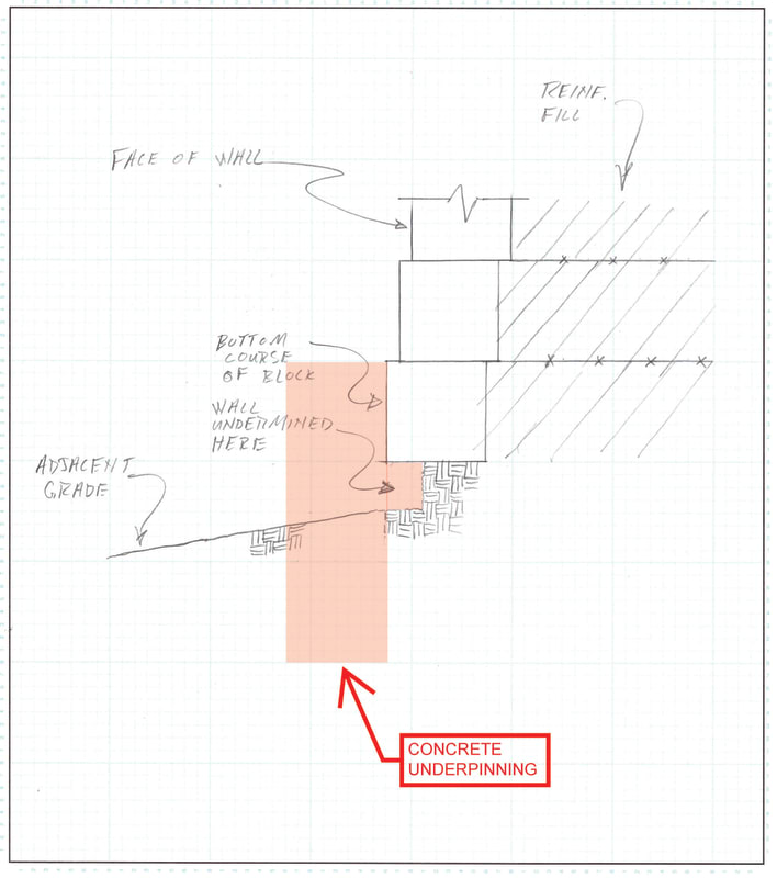

I am assessing a situation involving an existing segmental retaining wall (SRW) that is undermined at the base course due to inadequate embedment of the base course(s) below grade. The wall is approximately 150 feet long
and approximately 16 feet high (maximum). The adjacent grade at the toe of the wall slopes up gradually from one end of the wall to the other, so the base course of blocks steps up periodically as the grade slopes up. Due to inadequate embedment at the base of the wall and the stepped base course, there are two locations along the wall where the base course of blocks is above the adjacent grade (i.e., zero or negative embedment). At each of these locations the face blocks have been partially undermined due to loss of aggregate base from underneath the base course of blocks where there is negative embedment (see photos and sketch). The wall has been in service for approximately 20 years and appears to be in serviceable condition other than these two locations where the face blocks are undermined. Each of these locations is approximately 6 feet long.
I am looking for options to repair this condition to prevent further undermining and loss of bearing support under the base course of blocks at these two locations. Any suggestions on how to underpin the wall in these locations?

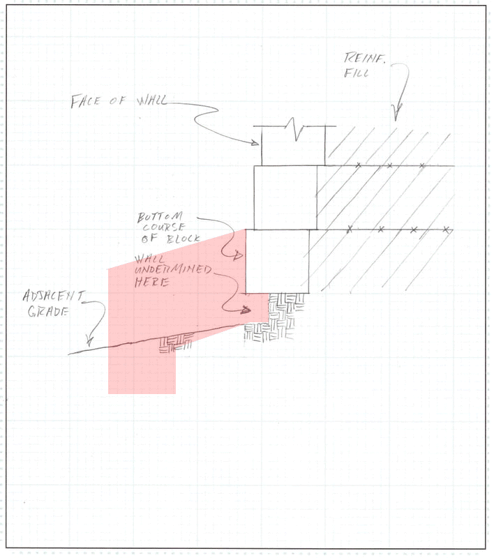

Maybe something like this?
The intent of the underpinning concept shown in the sketch would be primarily to act as a bulkhead to prevent further undermining by loss of aggregate base from underneath the base course of blocks.
Thoughts?

gte447f - I would consider your suggestion, but with a few changes:
1) Don't dig immediately adjacent to the existing wall. Move back, say, 1 foot, to excavate.
2) Slope top of concrete to ensure that rain water falling on the block is directed away from the wall.
3) Use reinforcing steel in the concrete.
If you construct a big block of concrete as shown in the above diagrams, where do you drain the water to from behind the wall?
The wall should have been constructed to a couple feet below finished grade. You may need to do some localized grading to bury the first couple rows of block, again being mindful of drainage.
SlideRuleEra, I was already concerned about potentially excavating directly adjacent to the front of the wall, so I like your suggested modifications to my original concept sketch. I am leaning toward recommending something like your sketch.

Regarding SlideRuleEra's comment about sloping the top of the concrete to ensure that rain water falling on the block is directed away from the wall, SlideRuleEra was referring to the concrete underpinning/bulkhead shown in the sketches above. SlideRuleEra is correct that the concrete needs to be sloped away from the wall.

Are those base blocks trimmed at the bottom? Are they set on an aggregate base, or possibly concrete? To me, easiest fix is to replace the leveling course and embed the wall 6 or 8 inches by adding compacted soil in front. Monitor over time and replace soil as needed. You could armor the added soil with some rip rap if needed maybe just vegetation would suffice.
Jrit, the blocks are not set on concrete. They appear to be set on an aggregate base, but I do not know the width or thickness because I did not do any excavation. It does not seem to have the dimensions of a typical aggregate base leveling pad, since the bottom of the blocks is at or above grade and there is turf growing right up to the face of the wall.
I don't think just dry packing aggregate base into the space under the undermined blocks will be able to achieve proper compaction to re-establish bearing support under the undermined blocks, and I don't think I trust 6 or 8 inches of soil to be able to develop adequate passive pressure to confine the newly placed aggregate base, so I am still leaning toward a concrete bulkhead/underpinning.
