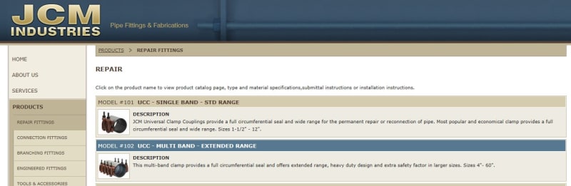

pipe clamp

If you are not planning to replace the segment, just put a clamp on it. Talk to the local water supply parts distributor about a repair clamp, as a 2 m clamp is available.
