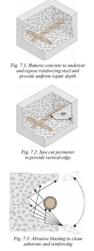

Do not patch that with non-shrink grout. Use a proper "Repair Mortar" I can't tell how deep the patches are but if 4" or less you can use a neat repair mortar. Something like Sika Top 123 Plus, or Euclid Duraltop Gel, or Mapei Planitop 23. I like these because they will mix the dry repair mortar with their proprietary latex admixture. This will produce a dense repair mortar with good bond. If the repair is deeper than 4", you will need to extend the repair mortar with some washed pea gravel.
Also, they need to square up those edges. The edges are all shattered from the chipping hammer. They should run an angle grinder with a diamond blade around the perimeter about 1/2" or 3/4" deep (don't cut the rebar) and then chip up to the perimeter of the sawcut line. This will produce a better repair with no feather edging.

1. Chip away to expose the rebar at least 1".
2. Square up the edges.

Its learned but you can review ICRI Guide for Surface Preparation for the Repair of Deteriorated Concrete Resulting from Reinforcing Steel Corrosion. There are resources out there.

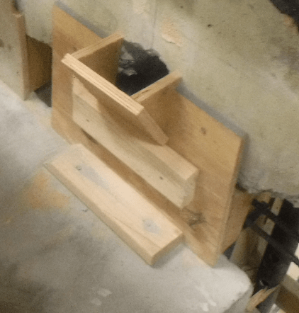

I would NOT hand patch this - too deep, and takes too long between layers. Best to form-and-place.
For a smallish and one-off 'structural patch' I would use a birdsmouth form and select your preferred SCC pre-bagged mix (Sika and BASF make such). Use a 1" needle/pencil vibrator and make sure the form's birdsmouth is wide enough for concrete placement.
Chip off the birdsmouth after the patch cures.
Surface prep (square cut perimeter, chip 1" behind rebar, etc) as other have stated above. No bonding agent - SSD, preferred.
My go-to patch material for such a scope is 'CTS RAPIDSET' (calcium sulfoaluminate cement-based) and with pre-bagged 'FLOW' and 'SET' control admixtures readily available (at Home Depot too!!) you are able to achieve the required workability/consistency without adding additional water. And sets up in 1 hour so the contractor does not have to return the next day to remove forms etc. for such a small scope.
If you go to ACI's website (concrete.org) and search 'RAP Bulletins' there is about 15 or so repair application procedure bulletins that go into detail on several repair techniques.
For example: Form-and-Place: Link
And FREE to members and non-members alike!
Downloaded the bunch... thanks for the link.
10" is deep. Ingenuity is correct, a pourable material as opposed to a trowelable material would be much better. In that case, something like Mapei Planitop 15 or Sikatop 111 Plus would also work. What Ingenuity is proposing, with CTS rapidset, is a rapid setting material that will harden in a matter of minutes (not hours). It's a good reputable brand (even though it's sold at Home Depot). This material is very helpful if you need to put foot traffic or vehicular traffic on the repair quickly. It will get hot and in my experience is more prone to cracking. I prefer Western Materials FasTrac brand of CSA repair mortars but they are harder to get.
You should definitely read the RAP reports. Their free and discuss all the different techniques for repairing concrete.

Perhaps I am wrong, but when exposing rebar due to honeycomb, other issues, we have alwyas chipped behind the rebar to ensure that the rebar is encased in the repair concrete. Tried to embed the attached photo into the response but wouldn't work . . .
