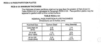

I have a task to repair an existing pass plate on an existing S&T HX channel (~5'-6" diameter channel, pass plate is 1/2"-thk, carbon steel) during an upcoming outage due to knife-edging expected on the pass plate edge where it bolts up to the existing tubesheet. The service for this channel is cooling water. The current plan is to demo a section of the existing knife-edge pass plate out & weld in a new 1/2"-thk plate section in its place. We'd be welding back to the existing channel cylinder & existing pass plate in this case. Curious if forum thinks this is the best repair strategy, or would just building up the existing knife-edge pass plate with a machinable Belzona metal repair paste-grade type product be a better overall strategy?
Normally in this kind of situation, we weld build up the part partition plate, which has suffered knife edging and machine it to get the required thickness on the edge. By this way welding to channel is avoided. In most case the pass partition plate will have a tapered thickness on the edge. Possibly for 1/2 inch (12mm) thick partition plate the tapered thickness will be 8-10mm.

I have old edition of TEMA and don't have latest edition of TEMA edition 11. It seems that TEMA Ed-11 has standardised the pass partition plate thickness as 5/8" , where as in old editions minimum thickness was based on Nominal size of Channel. Partition plate thickness used to vary from 3/8"(9.5mm), 1/2" (12.7mm) and 5/8"(15.9mm). If you can share the information from latest edition that will be helpful.
@ ShabsRBI
Note that OP said diameter 5'-6" = 66"
hence the thickness is 5/8" in your Table RCB-9-131, same as Table RCB -9.1.3.1 in the 11th edit

This means that pass partition plate being used for 5'-6" Channel is not conforming to TEMA requirements. Does this require replacement or shall be considered for continued service as it has worked well in the given situation?
Regarding the thickness, the requirement in RCB-9.1.3. is that you either use the thickness in the table, or the thickness as calculated per formula in RCB-9.1.3.2. That is clearly indicated on your snaphot provided above. If it is less than 5/8", you can still use your 1/2" plate if it can still hold the pressure drop across the plate based on the formula.

RCB-9.1.3 PASS PARTITION PLATES
RCB-9.1.3.1 MINIMUM THICKNESS.
The thickness of pass partitions shall not be less than the greater of that shown in Table RCB9.1.3.1 or calculated in Paragraph RCB-9.1.3.2. Pass partition plates may be tapered or step machined to gasket width at the contact surface

You can ALL CAPS "shout" all you want but the fact that TEMA now has a separate Appendix (and a non-mandatory at that) covering Repairs proves that the TEMA standards were never intended for new equipment. Table RCB-9.131 is not located inside Appendix B so it would not apply to this repair.
