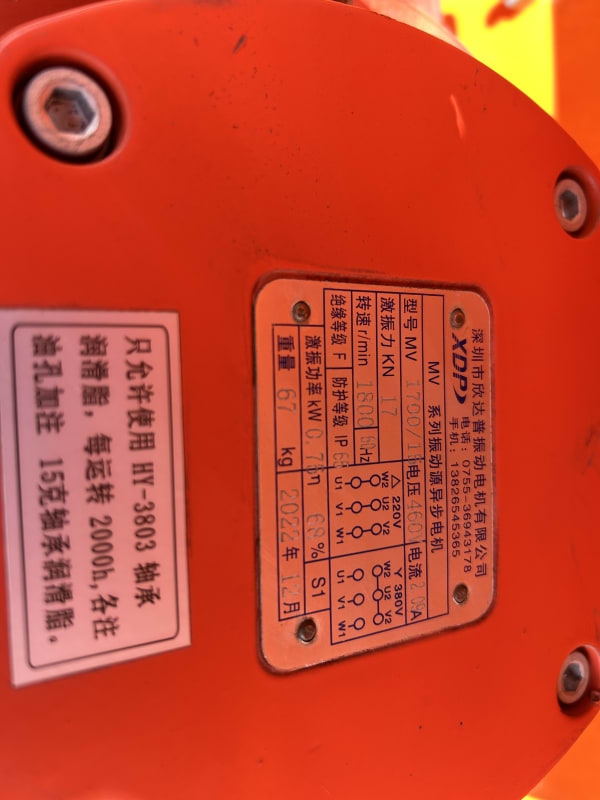

So I too have this same screener and am looking for a three phase Jenny to power. I came across a MEP-004a 15 kw near me. Looks like this particular unit is capable of 3 phase but only 416V. Is that correct and if so, will it just run the 460V motor a bit slower? This came up about three years ago in the following thread, which is now closed.

You will be able to run a 460V motor on 416V supply provided the reduced torque output at the motor shaft is adequate to drive the connected equipment.
416V is approximately 90% of 460V and generally motors can work at that level of input supply voltage. If the driven equipment demand is large requiring full rated power at 460V, the motor is likely to get overloaded (and trip) when supplied with 416V.

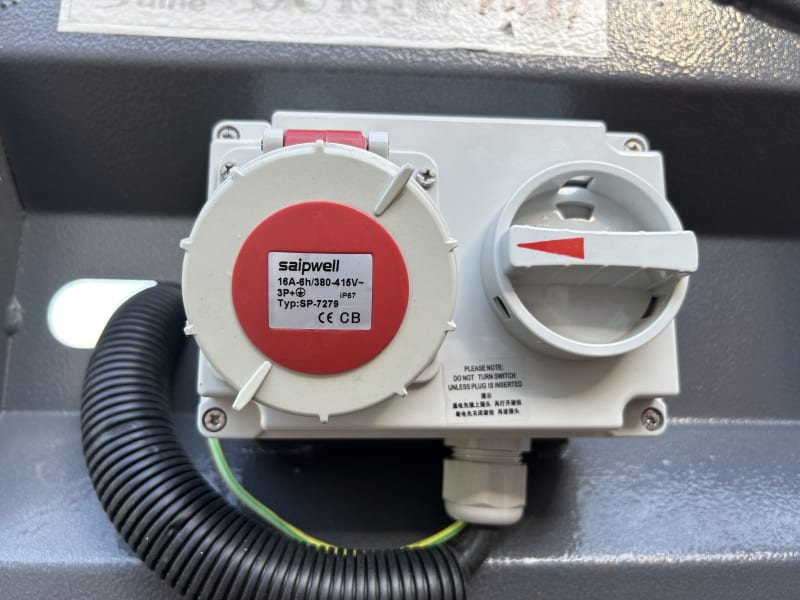

This is the plug for the unit, which made me think it would be a good Jenny to begin with.
The other option I think I would have is running the Jenny a bit past rated to make up for. I keep hearing that these military generators are underrated?
Speed of your motor is governed by frequency, not volts until you get close to your max power when it can start to slip more and then overheat.
Lower voltage equals less torque but also more amps for the same power load, so your motor heats up more and if run in hot weather at high load might over heat.

Connect your motor for 380 Volts.
Dial your AVR down to about 395 Volts.
