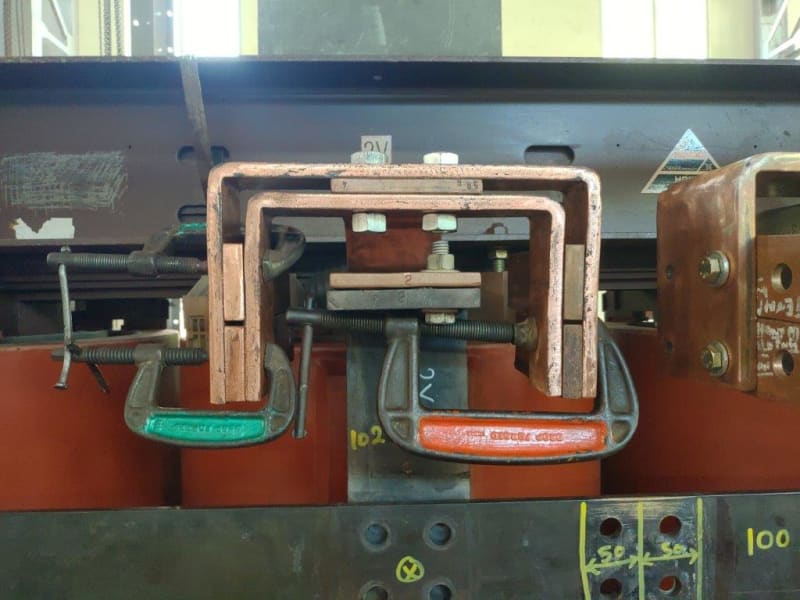

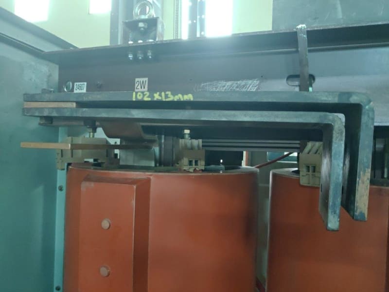

Old outgoing phase busbar (Inverted L shape) - 2x100x100 = 20,000 sq mm contact area
New outgoing phase busbar (Inverted U shape) - 8x50x100 = 40,000 sq mm contact area (Ignore the black neutral outgoing busbar directly below the phase lead).
