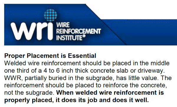

I have low opinion of wire mesh, but even the Wire Reinforcement Institute has a stern warning on placement:
Will the contract documents and field construction management ensure that correct placement takes place?

As for welded wire fabric...not a fan of that either. If you need minimal reinforcement, use small rebar and support on chairs to end up at the center of the slab or slightly higher.

The WWF placement has gotten better. It often doesn't end up just in the subgrade doing nothing. I always specify continuos chairs to be used for WWF support and even have a detail showing spacing. The mesh will get droopy from warkmen walking on it but it should still do a decend job of controlling the cracks.
