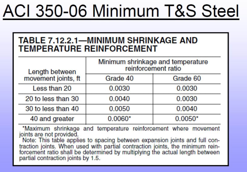

Below is the ACI 350 (2006) required T&S reinforcement schedule.
The newest version of ACI 350 requires a little more steel in regions where you have highly restrained concrete (corners etc..), but I don't think you get up to .008 reinforcing anywhere.

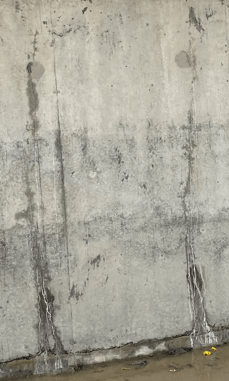

Attached is a typical photo of the cracking pattern that repeats.
Maybe the amount of shrinkage experienced was more than expected, which could be either a mix design or mix supply issue.
Perhaps pedantic, but 200 metres long and 30 metre diameter? Both can’t be right.
Whoops. Meant 30m diameter and circumferene of about 100m.
Looks to me like the tank tried to shrink while the dowels stayed put. Were the vertical bars on the outside?

That is the definition of restrained shrinkage cracking. It is inevitable, but can be limited as to crack width by placing enough bars close to the bottom of the wall, which is where the tensile force is applied. In this case, I would guess the concrete had a high w/c ratio.
