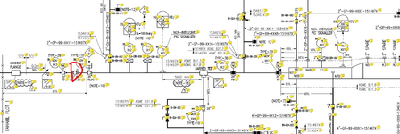

  • Congratulations 3DDave on being selected by the Eng-Tips community for having the most helpful posts in the forums last week. Way to Go!
Requirement of Manual Ball valve between ESDV and MOV in Pig trap area 2
Lawry1183
Petroleum
Feb 21, 2018
5
We have a 20" fuel gas pipeline designed as per ASME B31.8 with permanent pig traps. We have the PID which is indicated below. I would like to get technical insight on the requirement of this valve.
Second query on same PID - Also as per Design engineering practice for pipelines, " use of fittings between isolation valves, such as flanges and instrument taps shall be avoided". Does this means SDV shall be welded type rather than flanged?
Oh holy mother of god. Who has designed this monstrosity?
Clearly someone who works for a valve company or is getting a cut of their profits.
For one thing, you normally try and avoid anchor blocks if you at all can - they are the work of the devil.
They why are there three valves on the incoming line? You only need on welded ESD valve and that's it.
Is this class 900? Your LL of 100 bar is pretty high for a Fuel gas line.
The usual rule is that the first valve or the first connection on the pipeline side is fully welded and after that most people flange them.
A DEP sounds like a shell spec. I would have to see the whole section to understand that phrase listed as it doesn't sound right to me.
Oh holy mother of god. Who has designed this monstrosity?
Clearly someone who works for a valve company or is getting a cut of their profits.
For one thing, you normally try and avoid anchor blocks if you at all can - they are the work of the devil.
They why are there three valves on the incoming line? You only need on welded ESD valve and that's it.
Is this class 900? Your LL of 100 bar is pretty high for a Fuel gas line.
The usual rule is that the first valve or the first connection on the pipeline side is fully welded and after that most people flange them.
A DEP sounds like a shell spec. I would have to see the whole section to understand that phrase listed as it doesn't sound right to me.
Thank you @LittleInch..
Yes, it seems a lot of valve. That's the reason got perplexed by this arrangement.
We have reviewed the stress report and anchor block has been mitigated.
As per operations they require the esdv to be flanged to facilitate maintenance eventhough it's top entry design. Hence the consultant provided a welded mov and then flanged esdv so that when esdv taken for maintenance still the pipeline can be isolated with mov.
However,the requirement of the manual valve between the esdv and mov is still a mystery.
Yes the DEP is shell DEP for pig traps.
They want DBB upstream of the critical ESDV so that the ESDV can be safely removed without having to depressure the entire upstream pipeline. Otherwise, the Plant Owner may be forced to consider risky alternatives, of which there are many. But I dont see an intermediate bleed.
The DN500 MOV is a nice feature to have in case the ESDV is leaking upon emergency shutdown - operator can close this MOV from remote at control room if required. But where is the open - close pushbutton tag for the MOV?
Oh no, not that old chestnut about "but we need to be able to do maintenence on it".
Next time ask them how many times in the last 25 years have they ever had to either do any maintenece on a valve like that needing it to be removed or at all. Then wait for the silence. And why would they ever need to do anything to a valve which never closes other than twice a year to test it?
The probability that anyone will ever remove that ESD valve is minute. If they ever do then there are many ways to seal off the incoming line or just do it at the same time as you blow the line down for some other reason or when the plant is on turnaround.
ESD welded in valves on the entry into a terminal are a good idea. Adding in extra isolation valves is not. Basically where do you end?
Every valve is a potential leak path.
Those valves are there for catastrophic damage and shut off of most of the incoming supply. They do not need to be bubble tight.
Personally I've told the ops team to get real and it's for them to justify the $2M+ for something they will almost certainly never have to use. Again, expect silence.
I agree with LittleInch. It's a lot of valve and they are expensive.
The PID is for a Receiver Station. One HV/MOV, DIB (a DIB provides double isolation from one end, ie. upstream as apposed to single isolation for DBB) would have sufficed.
Welded/Flanged construction is not an issue as many gas station pipeline valves are flanged for ease of maintenance.
Similarly, I don't see why there should the two 20" FB Trap isolation valves? Relocating the 2"-GV-99-XX11-153461X between MOV-XX1 and the Trap could have avoided MOV-XX2. I would believe the 2" line is for venting.
They want DBB upstream of the critical ESDV so that the ESDV can be safely removed without having to depressure the entire upstream pipeline. Otherwise, the Plant Owner may be forced to consider risky alternatives, of which there are many. But I dont see an intermediate bleed.
The DN500 MOV is a nice feature to have in case the ESDV is leaking upon emergency shutdown - operator can close this MOV from remote at control room if required. But where is the open - close pushbutton tag for the MOV?
Yes, Operations team is also in sync with your post.
Oh no, not that old chestnut about "but we need to be able to do maintenence on it".
Next time ask them how many times in the last 25 years have they ever had to either do any maintenece on a valve like that needing it to be removed or at all. Then wait for the silence. And why would they ever need to do anything to a valve which never closes other than twice a year to test it?
The probability that anyone will ever remove that ESD valve is minute. If they ever do then there are many ways to seal off the incoming line or just do it at the same time as you blow the line down for some other reason or when the plant is on turnaround.
ESD welded in valves on the entry into a terminal are a good idea. Adding in extra isolation valves is not. Basically where do you end?
Every valve is a potential leak path.
Those valves are there for catastrophic damage and shut off of most of the incoming supply. They do not need to be bubble tight.
Personally I've told the ops team to get real and it's for them to justify the $2M+ for something they will almost certainly never have to use. Again, expect silence.
Thanks for your detailed explanation.
Operations team is removing the valve every 5 year for maintenance in the workshop. Hence they are adamant in providing the flanged ESDV and welded mov.
I agree with LittleInch. It's a lot of valve and they are expensive.
The PID is for a Receiver Station. One HV/MOV, DIB (a DIB provides double isolation from one end, ie. upstream as apposed to single isolation for DBB) would have sufficed.
Welded/Flanged construction is not an issue as many gas station pipeline valves are flanged for ease of maintenance.
Similarly, I don't see why there should the two 20" FB Trap isolation valves? Relocating the 2"-GV-99-XX11-153461X between MOV-XX1 and the Trap could have avoided MOV-XX2. I would believe the 2" line is for venting.
Thanks for your reply.
If DIB can be provided, then this manual valve with spectacle blind can be removed? if that is the case, then it will provide better isolation along with cost saving.
Thanks for your reply.
If DIB can be provided, then this manual valve with spectacle blind can be removed? if that is the case, then it will provide better isolation along with cost saving.
OP,
If the main line gas flow is unidirectional ( which I assume is yes, DIB is the best option). The first MOV XX3 is a welded valve, which is good for gas service. It has a better joint strength than a flanged valve, specially after the S-bend (U/G to A/G). The second manual valve is obviously there for isolation and maintenance of the ESV. The spacer is provided for positive isolation with a spade in the event the ESV is required maintenance. It is rare that the actual valve internal will go for maintenance. Most of failures in ESDV comes from the automation system such as solenoid valves, actuators. Regular testing of the ESDVs are the key. Many customers also provide redundant solenoid and actuator.
The two isolation valves on the main line is a good option for gas line which is more hazardous than a oil line.
Do you need two trap valves XX1 and XX2? The XX2 has also positive isolation with a spade blind.
Thanks for your detailed explanation.
Operations team is removing the valve every 5 year for maintenance in the workshop. Hence they are adamant in providing the flanged ESDV and welded mov.
Operations team are mad to do that. I've never ever heard of anyone doing that before.
You must make a small fortune to allow such a massive waste of money.
Why have they got this authority to spend prob $2M plus in CAPEX and God knows how much in Opex for zero operational requirement??
Operations team are mad to do that. I've never ever heard of anyone doing that before.
You must make a small fortune to allow such a massive waste of money.
Why have they got this authority to spend prob $2M plus in CAPEX and God knows how much in Opex for zero operational requirement??
It must be their SOP or their maintenance practice that they have to abide. Well the CAPEX and OPEX are there to be utilized, good for their contractors though
Consider this resource, you may want to contact those guys.
Safety is key for these application.
Pierre
Attachments
  • Pig Systems with Interlocking 2008-1.pdf
    1.3 MB · Views: 4
The bleed ( currently missing) on a double block and bleed is a key safety component. If you ask me, this is what you should recommend.
