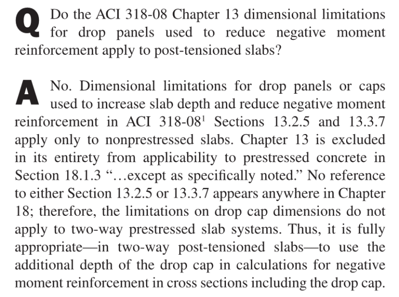

Except (according to this PTI FAQ author) post-tensioned slabs, where caps, evidently, can be used as additional depth for flexure...AND across the whole slab panel width too. Crazy in my opinion!
Link
Yes, PTI is crazy, in lots of respects.
the Q&A also appears to limit the consideration of the drop cap to the location of the cap ('in cross sections including the drop cap'), not across the full panel width.

No they are not saying that. They are saying that sections including the drop cap are essentially treated as T sections with the drop cap as the web and the full slab width as the flange. That is now they do it in their examples.
Engineering logic, statics, equilibrium, load paths and common sense appear to not matter!
rapt said:
That is how they do it in their examples.
Just to reinforce this point, two recent textbooks on the subject of PT design, one by Aalami and a second by Bondy & Allred have numeric examples using full slab panel width incorporating drop cap properties.
