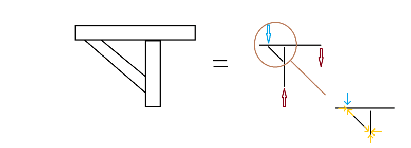

Ah, in my mind the beam loads straight down onto the diagonal which would create a moment arm at a distance d away from the column as shown below. But what you're saying is that the load from the beam will just become an axial compression load in the brace?
As long as the brace is connected at both ends, there negligible moment in the brace. If the brace is connected to the post/column above the foundation, the lateral thrust will create a moment in the post.
Bridgesmith has it. It's only compressive load in the brace. However it does impart a thrust load on the column if connected above the foundation, and also a tension on the floor beam to column connection in addition to the gravity aspects of the connection.
What are the mechanics of how that load does not result in a moment? Is there somewhere you can point me so I can read up on that? I believe you guys, but I'd like to be more educated about this because it's causing me to question everything I thought I knew about statics
Why not make it out of HSS and let the architect skin it with wood... seems a lot easier/safer/more robust long term.
JungleJoe - there is a moment, but it isn't resolved the way you're picturing it. A lot of it comes down to assumptions you make about the behavior. For instance, wood doesn't do moment connections very well. So the initial assumption should be that there is no moment resisted at any of the joints. Take a look at my quick paint sketch below. Do your FBD for the entire frame first. That will give you reactions at the two supports. Then look closely at the brace. The blue arrow is the applied load and the yellow arrows are the reactions within the frame. You'll have your brace in compression, the value of which will be higher than the applied load due to the angle. Then to maintain equilibrium you'll have a thrust force in the beam. Same thing happens at the bottom of the brace to get you back to a vertical reaction down at the foundation. But here the thrust puts your column into bending if applied above the base. This model is a bit simplistic. In reality, your brace will have an axial stiffness less than infinitiy, and its elastic shortening (and take up of any slop in the connection) will result in load sharing with the post through bending in the beam.
