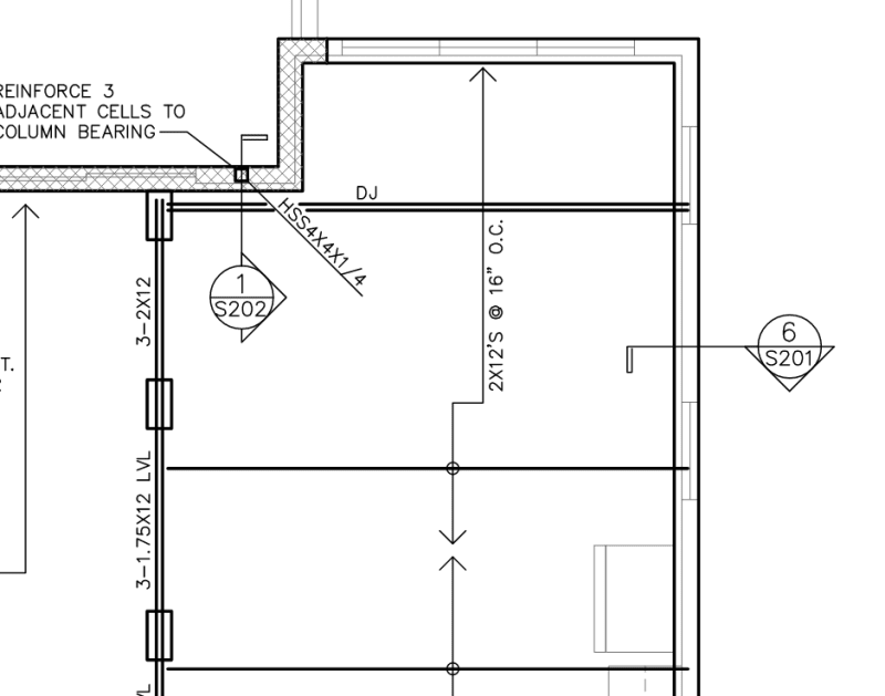

How do you all show joists for residential projects? I gained the majority of my experience in CT and NY and around there everyone shows the joists as harpoons. I am now practicing in GA and I am seeing most "architectural designers" (ie: unlicensed architects playing architect)drawing each individual joist on plan. This is a headache to look at to me but I am finding out that many contractors down here just cannot understand how to read my legend and figure out which way the joists go. Now I'm not sure if I'm crazy or if they're illiterate.

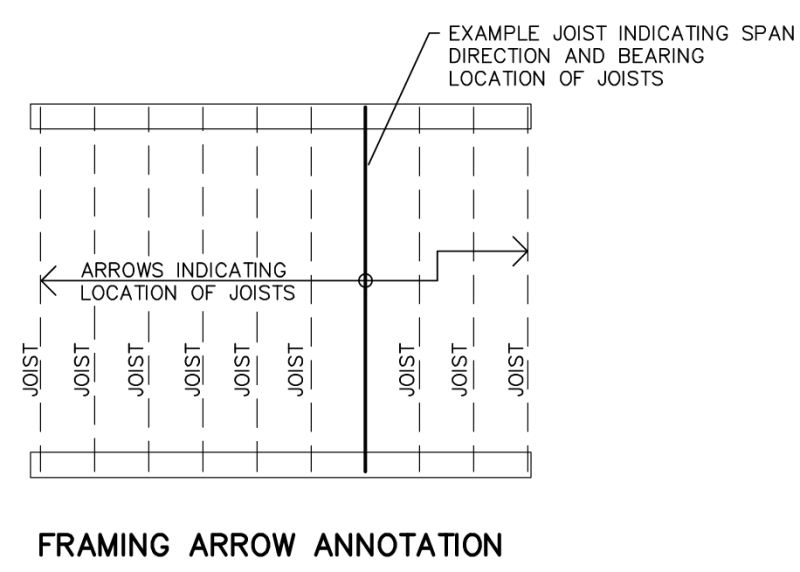

Here's how I have been showing joists for years with a legend included on every plan. Again, no problems before moving to GA!
I'm in SC and I do it like this, and include this legend on framing plans.
I've seen different arrows mean different things on so many plans. Some with just your 'harpoon' and no 'extents' arrow, and I'll have no clue which way they're supposed to be going, so I get why contractors would get confused.

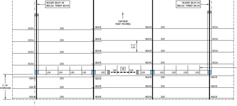

[li]Draw a few joists and note that the framing repeats beyond. This is far superior to the "harpoon" approach, in my opinion, as there shouldn't be any confusion in terms of which way the joist is spanning. See the image below for a roof plan I recently completed using this approach for the roof rafters.[/li]

TheDW - what is with those odd ninety degree jogs in that arrow, what is that accomplishing? Why do two arrows meet in the middle of nowhere? The spans are the same.

I like the jog to differentiate between the 'joist' line which is always straight, and its location arrows...I feel like 2 straight lines could have someone mistake which line is indicating joist and which is indicating location. If it gets too cluttered I don't do the jog

I am thinking I will just make my harpoon symbol a thicker and darker line so it stands out more than the extent arrows.
The span direction is obvious in the OP due to the layout, but if it were a square bay with the two arrow types I honestly wouldn't be 100% confident in which direction is intended, even with the legend. I would probably have to dig through the plan to find an obvious location like pictured to confirm that I understand the legend correctly. Maybe I'm just too used to my own style.

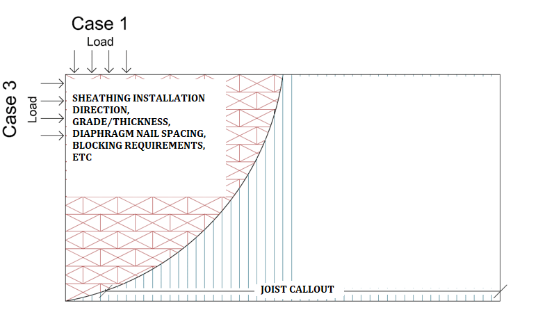

I do not like the harpoon approach, I find it confusing, particularly on multi-family projects where framing can change direction multiple times within a single section of a structure. I prefer showing several joists with the direction and joist callout, with the floor sheathing thickness/grade showing as well as the diaphragm nailing and blocking requirements in this area of framing. I will use something similar to the standard details in SDPWS, but indicating the notes above.
