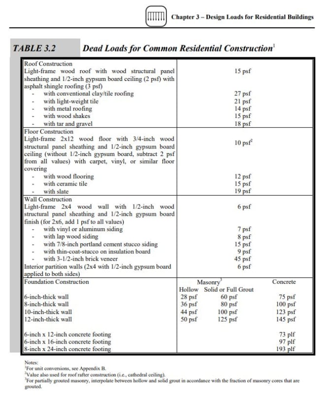

I've been designing using the dead loads from Design of Wood Structures ASD/LRFD - these dead loads would yield roof, floor and wall assemblies of approximately 20 psf. A lot of other engineers use assemblies closer to 15 psf, which is significantly less than the 20 psf for interior wall with plaster on both sides. For other wood framed residential engineers out there, what is the typical dead load you use for interior wall with plaster? Also, where do you obtain your dead load values from?

ASCE 7 table C3-1 shows a wood stud wall with gypsum on both sides as weighing 8psf...I usually use 15psf for everything you listed except floors where I start with 20psf.

I've been known to dip into the HUD design guide when I feel like sharpening my pencil/mouse.
