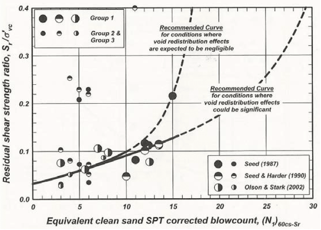

I would recommend your office reach out to a professional with an understanding of critical state soil mechanics and soils liquefaction before performing any analysis regarding liquefied sand using a friction angle of 28 or 10. Below are the images you will see in liquefaction study regarding cohesionless soil behavior dependent on a soils stress state.
When soil liquefies from seismic conditions it is assumed to follow an undrained path to the critical state line. If the soils void ratio is initially denser than its critical state it will increase in effective stress to reach the critical state line which requires more deviator stress. When you have looser soils it will decrease in effective stress to reach the critical state line which requires less deviator stress. Both of these paths will lead you to the soils critical state friction angle but at drastically different stresses.
You will see empirical correlations correlating the density state by corrected N values to liquefied strength ratios between 0.03 and 0.12 Sr/sigma', based on case histories.
