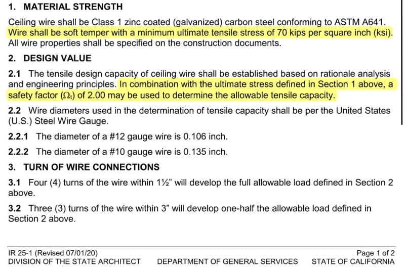

My questions:
1. How is everyone arriving at the capacity of the 12ga splay wire, and is it different than the SWL or the capacity used for the vertical wires?
2. Is it reasonable to back calculate a "dynamic capacity" for the 12ga wire based on an ultimate stress or tensile strength? In this case, what is the stress that is appropriate?

We've avoided the original questions which I'll clarify: what is the capacity of the 12ga wire when used in a seismic brace condition? Is it reasonable to take a lower FOS (say 1.5 or 2.0) versus the listed ultimate break strength? Can the break strength be calculated based on a listed tensile stress and, if so, does the tensile stress *really* vary that substantially between manufacturers and the listed ASTM standard?
Seems like DSA's IR 25-1 bulleting lays it out cleanly. Ultimate tensile stress = 70 ksi, define allowable tension capacity with FOS = 2.0 (min)
Yes, IR 25-1 for wire capacity and IR 25-2 (Link) for detailing. Similar to XR250, our preference is to follow IR 25-2 detailing and use 12ga splay bracing at a tighter spacing. This keeps the detailing standard to avoid installation errors / difficulties. Where I practice it's pretty common to need 8'x12' spacing, and in extreme cases you may need 8'x8', though I've never encountered that. You certainly shouldn't need to go as tight as 6'x6' or 4'x4'.
We went through this a few months ago. Like many niches in our industry, the more you dive down the rabbit hole the more inconsistency and lack of information you find. We’re in the Pacific NW and asked our clients to send us the docs for the strength of the wire they were purchasing. About 4 of our clients replied and each of them is purchasing wire from the same place in the Seattle area. The provided document listed 80ksi maximum and a maximum break test of 735 lb for 12g wire.
As mentioned, the drop wire is generally not an issue. For splay wire connections to concrete, we decided to design for the ductility of the wire in order to avoid Ω allowing for a smaller anchor size. With that, we design splay wire connections for 80 ksi wire, with (3) turns within 1'' (approx. 0.65 reduction derived from USGS Seis. Tech. Doc. regarding hanger wires), and a FS of 2. We list a minimum break strength on our drawings and have discussed adding a maximum capacity along with a minimum and adjusting the wire turns (4 turns or 3 turns with 3''). Not sure if our clients read any of it though, maybe this is all for practice (queue AI interview).
