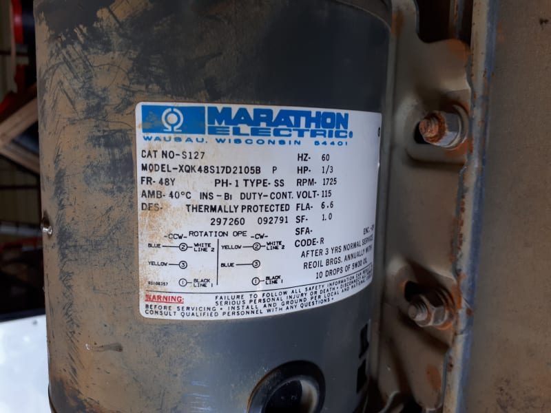

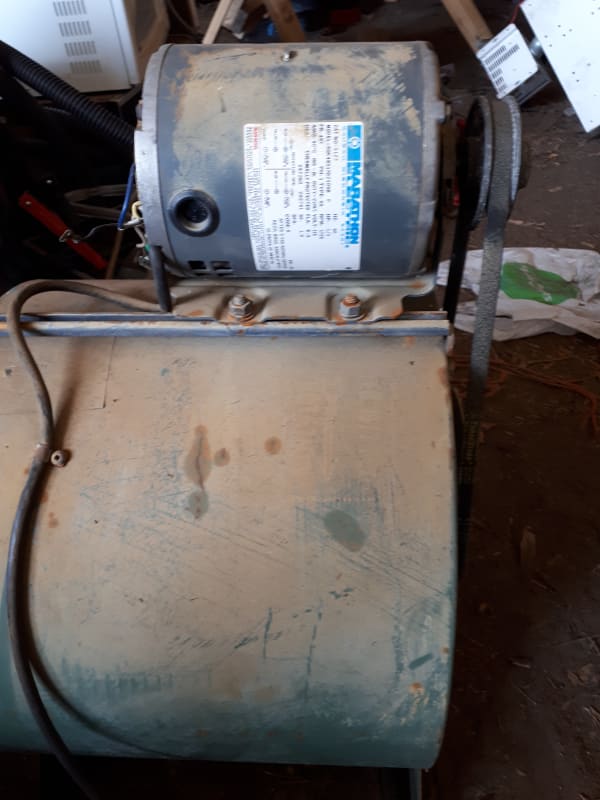

Hello. I have an old AO Smith 115 volt, 1/3 horsepower, two speed (1725/1140 rpm) motor from a belt driven fan. When trying to start, it was just humming, but would start and run fine if the fan was spun manually. I thought perhaps bad start capacitor or bad centrifugal switch. I realize I can replace motor pretty cheaply but wanted to try to fix this one. I removed the motor and found there is no start capacitor. It was extremely dirty so I cleaned it up. Centrifugal switch was dirty but contacts were not welded. Switch seems to manually operate ok but I suspect springs are weak because of how old it is.
Reassembled the motor and wired it to a plug and cord so I could bench test it before reinstalling. Hi speed = 115 volt, common = neutral, lo speed = no connection. The available outlet is GFCI which well may be part of the issue. When I powered the motor (no load), it started immediately but tripped the GFCI quickly, two seconds at most. Their was a visible spark internal to the motor when the GFCI tripped. I took everything apart again and didn't see any burn marks or other damage. Got lazy and decided to try again but same results.
I decided before trying again on a non-GFCI outlet to try to check the winding resistance, which is obviously something I should have done previously. I'm confused by what I found because I thought the start winding should have higher resistance than the run windings?
Motor off and centrifugal switch closed
Hi speed to common = 1.7 ohms
Lo speed to common = 1.7 ohms
Motor off and manually hold centrifugal switch open
Hi speed to common = 2.7 ohms
Lo speed to common = 6.4 ohms
Does that make sense? Looking for any input before testing again since I don't want to needlessly burn up the start winding if something is obviously wrong.

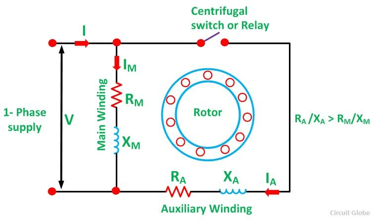

This is a fan and motor removed from a residential heating furnace.
These are common in North America.
There are millions of them in use across the continent.
They are called split phase motors.
It has a centrifugal switch but no capacitor.
They are also popular for small single phase centrifugal pumps and small turbine pumps.
Split Phase Induction Motor
The Split Phase Motor is also known as a Resistance Start Motor. It has a single cage rotor, and its stator has two windings known as main winding and starting winding. Both the windings are displaced 90 degrees in space. The main winding has very low resistance and a high inductive reactance (High X:R ratio)* whereas the starting winding has high resistance and low inductive reactance. (Lower X:R ratio)* The Connection Diagram of the motor is shown below.
* Notes added.
