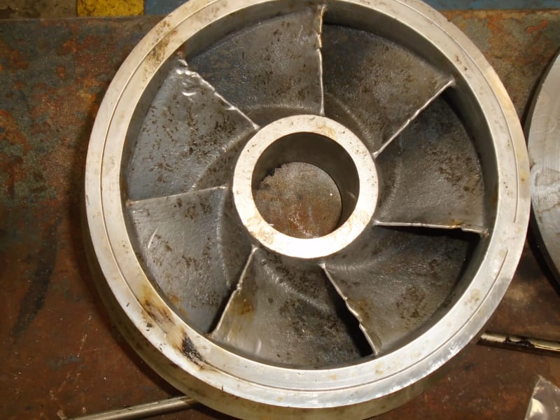

Here are few examples of damage mechanisms (I have seen in pumps) and we can discuss deeper on what actually happened here.

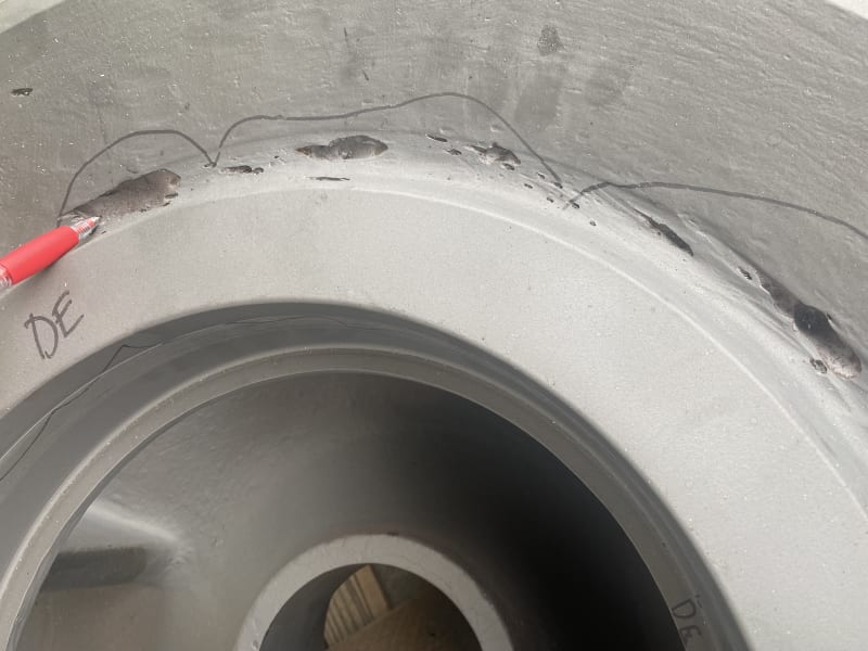

CA6NM SST material impeller used in waste water service (Vanes damage).

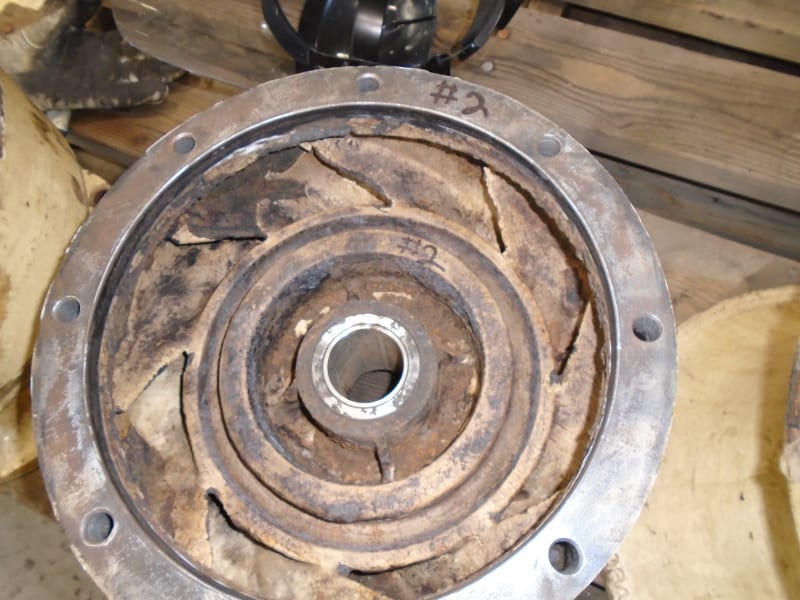

Cast Iron Class 30 vertical turbine pump "bowl" used in waste water pump (vanes damage)

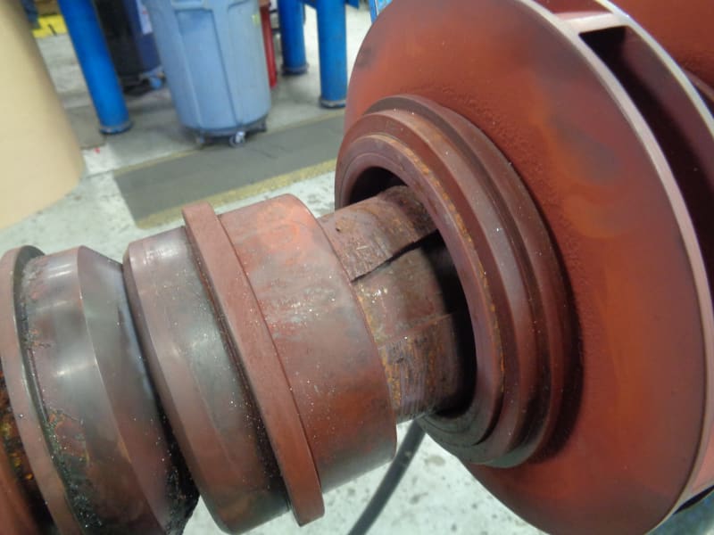

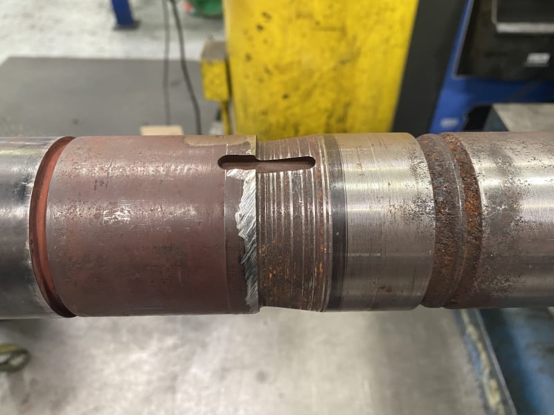

410 SST shaft damage on throttle sleeve fit in boiler feed water service (280 F).
410 SST throttle sleeve (high pressure side) found broken upon disassembly in same boiler feed pump.

Foto #1 - looks like damage caused by a foreign piece. I saw similar damage when bricks got to suction line.
Foto #2 - looks like cavities caused by lacking of NPSHA. See fotos in para 2.86 Karassik's Pump Handbook or another relevant source.
Foto #3&4 - I'm a process engineer, better ask a mechanical engineer.

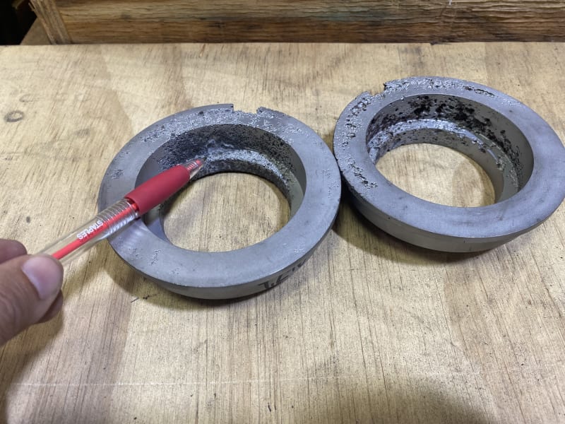

Throat bushings used on low pressure side of axial split boiler feed pump
Mech5656 said:
Can you comment on damage mechanism below also? Throat bushings used on low pressure side of axial split boiler feed pump
Unknown. I would name it pitting corrosion caused by local acid/alkali accumulation. Repost on Corrosion forum.

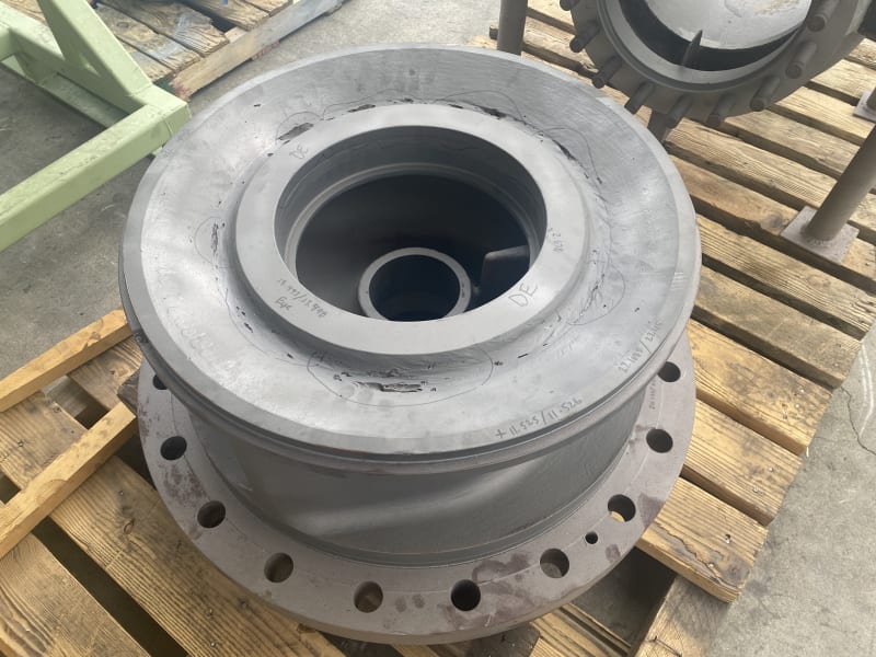

Also, can you comment on these damage marks on pump cover/head. Looks like extreme abrasive particle attack. Sorry for putting too many pictures. I am looking into past folders and checking out different damage mechanisms.
Unknown. I did not understood which detail of pump it is.

If you are dealing with BFP they are most likely pitting corrosion which is the result of working under cavitating conditions in the suction side unless they are from manufacture. First you need to check the NPSHA vs NPSCR. Check the pump curve, and get some more information from the process on pressures and elevations to compare.
