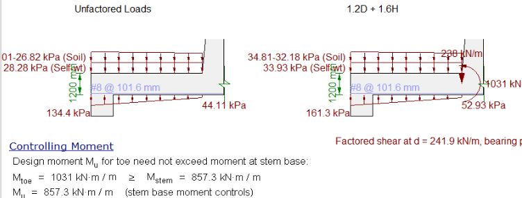

I was perusing a particular retaining wall design example
For the design moment for the toe at the stem
if the pressure on the toe creates a larger moment
than the moment in the stem
the max moment for the stem overrides the larger moment for the
toe using the pressure
I can't think of an example of a retaining wall where this is the case.

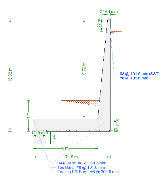

A wall entirely comprised of toe?
Terminology thing then? To me the toe of the retaining wall is the portion which it rotates around, therefore it is on the dredged side. The heel is buried beneath the retained soil.
In that instance, the overburden pressure is always greater than the bearing pressure from below due to statics.

and usually the toe design moment would be less than the stem moment
and you can design for this moment below stem moment
i'm just trying to figure out the reasoning behind not using the greater moment.
and whether to use this procedure for design.
here is the example
I feel like something is not quite right, but I'm not going to write a math proof to figure it out. My brain, which like simple rules, says that heel + toe = stem, approximately. Therefore, toe > stem requires heel < 0, so false.
yeah something seems fishy with that example, from a pure statics perspective I'd also expect the moment created by the shear key resistance to be included in the toe design. I'm used to seeing the key directly under the wall stem.

Mu[toe] at middle of ftg. = [(8.5 + 0.6)/8.5]3*857.6 = 1052kN-m per m
So the difference is a result of the thickness of the footing, namely 1200mm.
I see no reason to use the lesser moment for the footing, particularly as we are turning a 90o corner which has its own issues as has been discussed in another thread. I would reinforce the footing for 1052kN-m per m and give careful thought to turning the corner into the wall.

Agree with BA.
@BARetired why use back same active pressure concept with extended half thickness of footing
and not use pressure distribution from P/A +- M/Z to calculate moment in the toe?
@BARetired you have a link for that thread?

Same answer either way. Equilibrium demands it!
EDIT #2: Let me re-phrase that. It should be the same answer either way. It not, the toe pressures are incorrect.
BA
if equilibrium required
wouldnt the stem need to be now reinforced for the higher moment then
active pressure?
active pressure?
if equilibrium required? Equilibrium is always required for any structure which is not in motion.
No, the stem need not be reinforced for higher than active pressure. The maximum moment in the stem occurs at the top of the footing, so the stem moment is correct as calculated.
The maximum moment in the footing occurs at the point where a vertical plane through the leftmost contact between wall and footing meets the neutral axis of the footing and decreases toward the toe. The eccentricity of the wall and the end of the footing would decrease the footing moment slightly, but was not included as the wall dimensions are not known.

What's the width of the footing?
