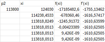

Dear pierreick, I have been working on the Newton Raphson method and it is now in Excel. I am just not yet getting the values I expected or want. I may have entered the wrong unit for some numbers or entered them incorrectly.
T = Which temperature should be entered here? The absolute or the temperature in the piping?
M = Molecular weight in g/m or kg/m? and then should you use 16 g/m for biogas?
G = Here I did the mass flow kg/s divided by pipe surface m2
With the A,B and C I came up with the following numbers
A 0,007075
B 1032,245
C 29071,62
F = 0.007075*(113800^2-xi^2)+ 1032.245* ln(xi/113800)+29071.62
F' = 1032.245/xi - 2*0.007075 *xi
And see the picture as how it was done in Excel
Sorry to ask for help again, if you see what I did wrong I would love to hear it. Thanks in advance.

Seems OK to me. If you share your process data and piping arrangement I can have a deeper check.
You must initiate P1, P2 is a given data. P1 higher than P2.
As other said your Mw is a combination of CH4, H20 and Co2 at least. The temperature is the temperature of the product flowing in the pipe, in Kelvin.
I'm familiar with the SI system.
Note: BTW it's easy and more accurate to add the fittings and other valves to get a more accurate result.

Pierre, if you don't see laminar flow in digester design at minimum temperature, minimum flow, you probably never will.

I suppose that under extreme conditions it is possible to get laminar flow, but that would not be the design condition. It's a bit like saying that if you close the valves completely there will be no flow.
I'm afraid this thread has gotten lost in the weeds. There are much more important considerations than how to calculate the pressure drop. Before looking at the pressure drop calculations I would want to know how many of the 10+ fermenters are running at once? What is the batch time? What is the gas generation profile over the batch? How are the fermenters spaced and located relative to the gas conditioner? What is the composition of the gas? Does it vary? What are the real pressures? Plenty to consider before we get into the detail of deciding on the calculation method.
