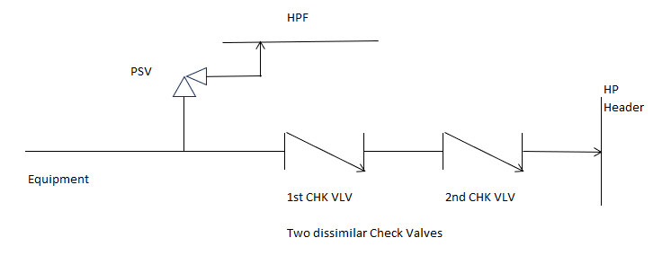

Hi all,
There is a HAZOP item to protect U/S equipment from a reverse flow coming from a high-pressure header.
There is a PSV D/S of equipment.
There are two dissimilar check valves to prevent the reverse flow.
In case of double jeopardy, when one of the check valves failed open, and the second one has leakage or failed open too the PSV will function to protect the equipment.
-Can we take advantage of each check valve port area as an orifice to drop pressure before functioning the PSV?
If yes,
-Is there any rule/API guidance specifically for sizing of check valves to ensure the PSV will fully protect the Equipment?
Thank you,

Is this HAZOP part of PSM? Because as soon as I hear double jeopardy cases being considered, it's giving me pause. Can you share a P&ID or sketch along with the controlling case causing the double jeopardy? What are your layers of protection? Are you considering double equipment malfunction as a controlling case?
I think the accepted flow is 10% area, so 2 is 1% of area.
I'm not aware of any HAZOP which considered check valves failing open. That's not a credible scenario in my view.
Are both or only one of these check valves tested and maintained every year ? Or neither ? Are they marked as safety critical check valves on the PID and Operating Manual? And included in the plant safety critical annual maintenance list ?

My hang up is what OP is meaning by double jeopardy. What two abnormal conditions are being considered to be happening simultaneously?
Check valve one and check vale two failing?
Abnormal header pressure and both check valves failing?
Neither of these I would consider double jeopardy cases.

If under normal operations the header pressure can exceed that of the design pressure of the equipment. Check valves should be assumed to be able to leak under normal operation. Then there should already be a system in place to handle that pressure and flow at the leak rates Littleinch indicated, to prevent overpressure of the equipment and PSV. The simplest system I would consider would be a FC valve between the equipment and checks. Since OP did not mention any device between the checks and the equipment, my concern is that the checks are being used to protect the equipment under normal operation. Which leads me to, why a HAZOP in the first place? Are they popping the PSV on the equipment because the checks have started to leak and are now considering validating the size of the PSV to handle that flow rate? Leading to, if we consider the check port area, we can use a smaller PSV? If this is the situation, I would be concerned that the HAZOP itself is making invalid assumptions on what a normal vs abnormal case is.

I think DJ is one valve failing and the other passing. Failing is a bit vague...
There is not. Each operator sets its own acceptable limits, e.g. see

Number of Check Valves in Series 2 or more. Partial failure of one check valve.
Failed check valve behaves as a restriction orifice with a diameter equal to 1/3 the nominal diameter of the check valve. Each of the remaining check valves in series is assumed to behave as a restriction
orifice with a diameter equal to 1/10 the nominal diameter of the check valve.
Number of Check Valves in Series 2 or more. Total failure of one check valve.
Failed check valve is ignored. If only two check valves in series are installed, assume the second check valve fails partially open and calculate back flow assumed failed check valve behaves as a restriction orifice with a diameter equal to 1/3 the nominal diameter of the check valve. If more than two check valves in series are installed, assume that each of the remaining check valves behaves as a restriction orifice with a diameter equal to 1/10 of the nominal diameter of the check valve.

BP's std. GP 44-70 said:
6.6. Reverse flow
a. Overpressure resulting from reverse flow from a high pressure system shall be considered. No credit shall be taken for the presence of a single check valve or steam trap in a line. The following shall be considered:
1. Two check valves in series may be used as a means of overpressure protection, provided that the application and subsequent reliability and maintenance complies with GP 48-03. The installation of two check valves shall not be the sole means for isolation of low and high pressure sources. A positive means of isolation of the line shall be installed for maintenance.
2. Two dissimilar check valves in series used for overpressure protection shall only be used in clean, nonvibrating, nonpulsating services and shall be periodically maintained and tested to improve reliability by eliminating common mode valve failures.
3. If two check valves are used as a means of overpressure protection, their use shall be clearly documented in design, included in a register of safety critical equipment (e.g., the relief and overpressure dossier), and be subject to approval by the appropriate EA.
4. If the reliability of two check valves in series cannot be ensured, the reverse flow leakage rate shall be based on calculated flow through a single orifice with a flow area equal to 10% of the largest check valve flow area.
5. Orientation of check valves shall ensure that the check valves can function reliably in accordance with manufacturer recommendations.

(i) If one check valve is present, as a DESIGN CONTINGENCY (i.e. relief valve sizing cause), assume backflow equals 10% of forward flow. Where the normal flow is liquid (e.g. pump syste) but backflow may result in liquid followed by vapour, the vapour to an orifice with a diameter of 1/3 the valve diameter (i.e. approx 10% of a valve area). As a REMOTE CONTINGENCY (see below) assume check valve fails fully open.
(ii) Is two dissimilar check valves are present in series, the as a design contingency, assume one check valve rate. As a REMOTE CONTINGENCY assume the first check valve has failed completely and second leaks a rate based on 10% backflow.
I attached the Schematic
Hi @LittleInch Thank you for this guidance, this is exactly what I found in API 521 section 4.4.9.3.3 indicating all possible cases (as assumption) for a Reverse Flow Through Failed Check Valve:
1- The Failed Check Valve has No Flow Resistance in the Rev Flow Direction
2- The Failed Check Valve has the same flow resistance in the Rev Fl as in the Forward Fl direction
3- The Fld Check Vlv is equivalent to an Orifice equal to the check Vlv flow area without internals
This section also explains:
When multiple Chk Vlvs in series, assumed the smallest has completely Failed, all others have leakage, Two different practices are used to estimate the Rev Fl rate:
A- The Check Vlv as an orifice with a diameter of 10% of nominal Fl ID, (Orifice equal to 1% of Nominal Fl Area), so the Rev Flow is calculated using the Orfc area, then the Max Op P on the side normally D/S of the CHK VLV, and the allowable accumulation on the side normally U/S of the CHK VLV.
B- 10% of Normal Fl rate as the CHK valve as an orifice. The difference between the Max U/S and Max D/S pressure is used to estimate the orifice area. To calculate the Rev Fl Rate, the orifice is then rated using the relief fluid properties, and the allowable accumulation on the side normally of the chk vlv
