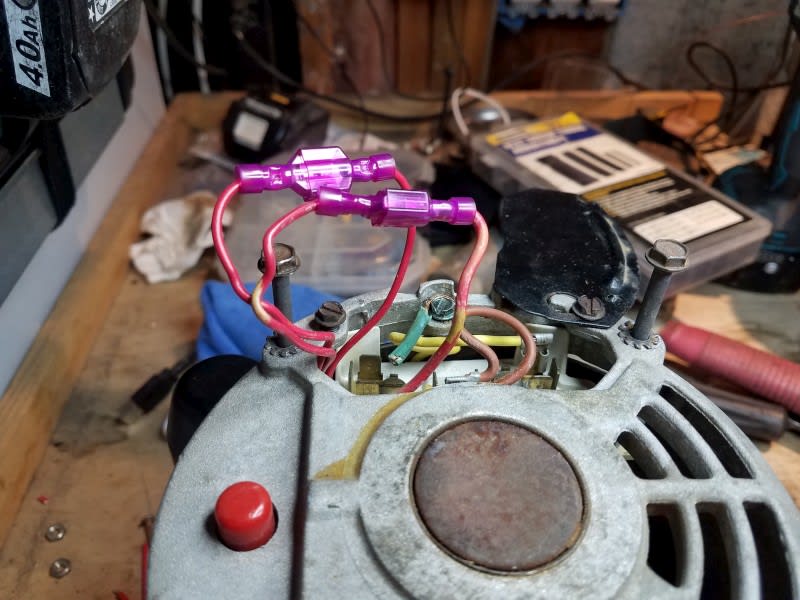

There are 7 wires coming out of the windings, indicated with red arrows in the attached pic. I assume the black wire on the right is one of the start winding wires. I need to swap that with the other start winding wire, correct? Could someone please let me know what other wire?
Did you happen to notice the statement on the label that it is not reversible?
In this case 'non-reversible' means that the common point between the start and run windings is not easily accessible. It is buried under the strings and wrappings. The start winding is the finer gauge wire. This is also a dual voltage motor so you really have to understand what you are doing to reverse it. It will involve cutting through the wrappings, cutting wires, and soldering new lead wires.
I think that I see six wires going to the terminal board.

That are often two run windings with four leads and one start winding with two leads.
There is a black wire from the terminal board to the capacitor and one black wire from the capacitor to the windings.
Temporarily short the capacitor terminals together.
Look for continuity from the black wire on the terminal board to one other wire on the terminal board.
Check that these wires do not have continuity to any other wires.
Otherwise you have a problem and the motor is really non reversible.
If you have continuity from the black wire to one other wire only, interchanging these two wires should reverse the motor.
Replace all other wires on the proper terminals.
Remove the jumper across the capacitor terminals.

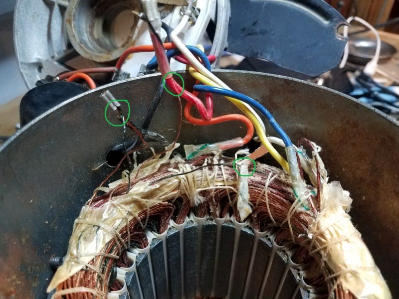

Edison123, I thought about rotating the stator. There is a gap through which I can extend and feed the wires. But as Waross guessed, the stator is in fact closer to one end and the windings aren't centered in the housing.
I've narrowed it down to 3 wires, black red and brown. I did some cutting to see what wires are connected to the small winding. The problem is there are 2 small windings, not just 1. One winding is copper colored and one is dark green. The black wire that goes to the start capacitor is connected to both windings. How do I know which of those is the start winding? Or are the both start windings because this is a 120/240V motor?
BTW, the remaining wires (blue, yellow, white and orange) were only connected to the large run windings.
If the red and brown wires are both connected to the same terminal then they are both start windings.

Brown goes to the run capacitor. Red goes to the board, where it splits out to the orange wire and the thermal shutoff switch.
Do you think they're both run windings? If they are maybe I should swap them both?
There should be two start windings in a dual voltage motor. They are connected series or parallel for high or low voltage, just like the main windings.
VERY UNLIKELY.
The overwhelming majority of that size motor use a single start winding.
The start winding is in parallel with ONE of the run windings and thus always receives 120 Volts.

A single phase, two pole, motor needs all the help that it can get to start.
A typical "Capacitor Start, Capacitor Run" motor uses two capacitors to start and one capacitor to run.
A smaller value of capacitor is used for running as is used for starting.
Rather than two capacitors, this motor may be using two start windings and one capacitor.
In that case, only one start winding would be switched by the centrifugal switch.
This would make it very problematic to reverse the starting winding.
But we are not done yet.
Identify one pair of run winding leads and reverse them.
Identify the second pair of run winding leads and reverse them.
Don't change the start winding connections.

It works! I swapped the copper start winding wires and it reversed rotation. I extended the wires and added spade connectors in case I ever want to change rotation again. Thanks to all who contributed, Bill, Muthu and Compositepro. And to jraef, Mr. "..statement on the label...not reversible", you go on being a good little sheep and believe every label you read.
