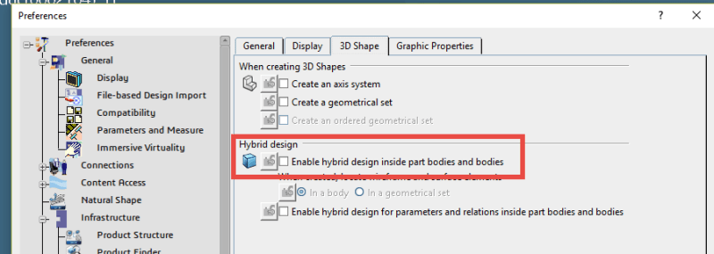

I don't know if my method is correct or not but for ribs/slots, I create firstly center curve and secondly profile based on the center curve (profile is associated to center curve).
My problem is the order that these 2 elements are aggregated under the command. As you can see in the picture the order is: 1. profile, 2. center curve. In this order, I can't edit the profile (can't see the center curve)
Can I change the order of aggregation? Or do you have any advice to change this method?
do you work with HybridDesign option ON ?
I have the option off and even if I play with usual suspect options I see both curve when I edit any of then...
But with the option ON when I edit one sketch I do not see the other one.
Well I tested for 2 minutes so plz don't over-react if I did no test enough and if the solution is somewhere else...
Eric N.
Thanks for your care and spening your time on my issue.
I work in hybrid design. And seeking a solution to change the order of aggregated elements.
Try this:
1. stay in Hybrid Design
2. add a Geometric Set to you model
3. move the Center Curve sketch into the Geometric Set
4. move the Profile sketch into the Geometric Set
