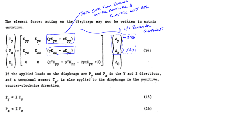

Long shot but does anyone either know what the reference is or have a PDF copy of the reference on Enercalc's help page under the "Analysis Procedure" heading here: Link
or alternatively know how to or have a good reference for assembling the global stiffness matrix for the system in the attached sketch:
I'm getting tripped up with the formulation of the K's for the rotational degree of freedom.
I get the following for just the translational K's
[[1,0],[0,0]] + 2*[[0,0],[0,1]] + [[0.5,0.5],[0.5,0.5]] = [[1.5,0.5],[0.5,2.5]]
where the 0.5 K matrix comes from the transformation for the 45 degree spring using [[C^2,CS],[CS,S^2]] where C=Cosine and S=Sin which is a reduced form of the full transformation matrix.
From the linked reference that would lead me to:
[10,0,0] = [[1.5,0.5,Ktheta1],[0.5,2.5,Ktheta2],[0,0,Ktheta]].[Ux,Uy,Utheta]
I attempted using the Ktheta definitions from the link but I was not able to determine the J term in the lower right Ktheta term and applying what I did come up didn't result in any rotation for the system which, looks to be an issue with the last row which would take the form: 0 = 0 + 0 + Ktheta*Utheta which would seem always result in a Utheta=0?
The K matrix should be symmetric so the two 0 terms for Dx and Dy in the Moment line should really be Ktheta1 and Ktheta2. Making this substitution I get approximately the same solution now but the difference is high enough that I don't feel as though I have it completely correct.

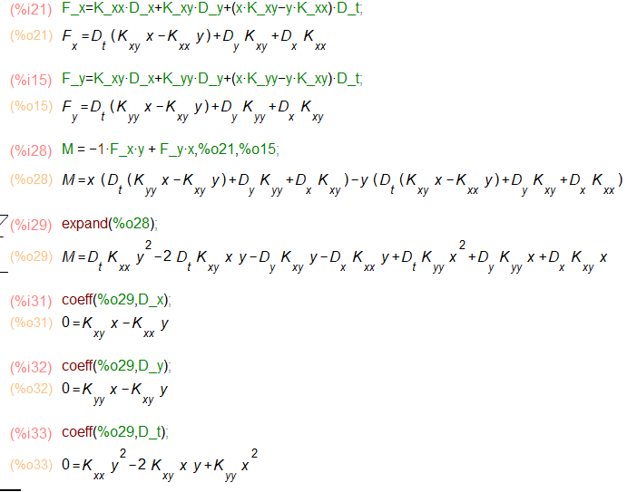

Backup for the 0 terms in the M row needing to actually be the two Ktheta terms:
Taking moments about the datum point with positive moment being counter-clockwise
M = -Fx*y+Fy*x
Where Fx and Fy come from the first two rows where the rotational components of the deflection have been put back into the stiffness side of the function:
Back substitution into the moment formula yields the following coefficients on the delta terms (x=y and y=z for comparison):
Using this matrix arrangement removes the need for the J term in the moment which would need to be solved by reducing the Dx and Dy K terms to 0.

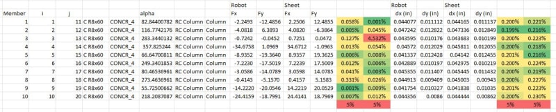

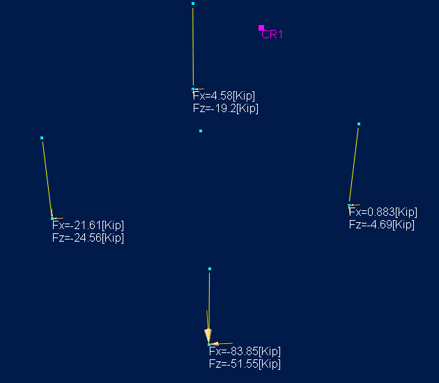

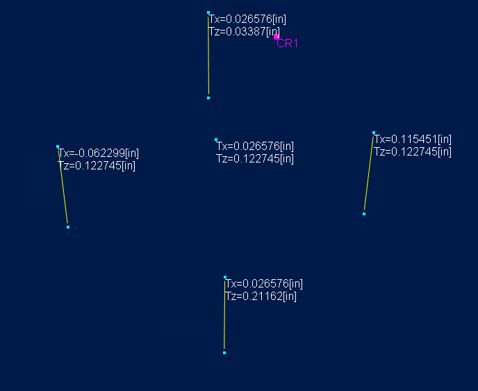

to close the loop on this I corrected a few minor errors and worked out my own basis for the stiffness matrices and now have near exact agreement with a handful of software packages with the exception of Enercalc. It appears that Enercalc's rigid diaphragm tool may be mixing up it's own sign convention internally during the force recover stage as the results diverge rapidly from other well known software packages when angled walls are added into the mix. The Enercalc results can be off by 10’s to 100’s of kips.

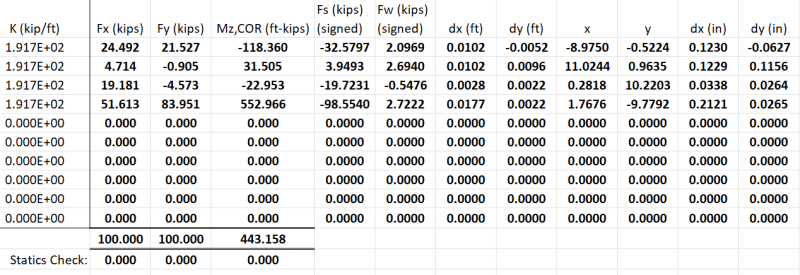

A copy of the amended spreadsheet can be downloaded from here: Link

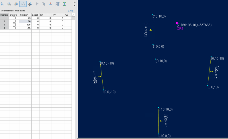

In the following images the Excel X,Y axis correspond the Software Z,X axis:
the test model consists of 10ft tall 60"x8" 4 ksi "columns" with fixed bases and free tops
All top nodes are assigned to a common rigid diaphragm in the software package
Applied loading is at coordinate (0,0) Fx=100 kips, Fy=100 kips and My = 100 ft-kips
Excel:
Software:
Center of Rigidity and Member Rotations (positive rotations are counter-clockwise as measured from the software Z axis or Excel X axis):
Reactions (Excel Fx, Fy are forces applied to the diaphragm or -1*Reactions):
Displacements (compare to the Dx(in), Dy(in) columns in excel):

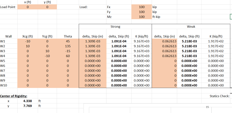

Initial intent was verification of the force distribution reported by our software. The sheet in its current form reports lateral element in-plane and out-plane forces and global x,y displacement.
Wall/Lateral resisting element stiffness' are entered as in. displacement per 1 kip load in the strong and weak directions (ie analysis of strong and weak deflection under a 1 kip load needs to be done somewhere else currently). Values of 0 stiffness can be entered for either strong or weak axis as well. Design of each element would need to be done elsewhere also.
Automatic wind/seismic load application inclusive of accidental eccentricity is not done, the sheet is currently set up in a general sense where you tell it a single load vector and point of application.

Strictly linear in this application. The displacements indicated are per element centroid and are in the 2D plane of the diaphragm.
More or less boils down to F=Kd
K for each element is taken to be a 2D spring with i and j nodes occupying the same coordinate and the j node part of the rigid diaphragm.
Each spring is assumed to only have a strong and weak axis value such that the Kij = Kji terms are 0 for the elements local stiffness matrix.
Each elements stiffness matrix is transformed to the global x and y axis of the diaphragm by applying the formula:
TTKT = K'
where TT is the transpose of T and T is the standard rotation matrix found in most matrix structural analysis texts.
out of K' we only need the bottom right corner entries associated with the j node of the spring for the global stiffness matrix of the rigid diaphragm. This is because all i nodes of the springs have translation restrained so the partitioned form of the global matrix will have all unknown displacements associated with the rigid diaphragm.
To form the global K matrix for the rigid diaphragm:
All nodes are rigidly linked such that the direct x and y displacements are the same at every node so,
Fx = sum(K'11)dx + sum(K'12) dy
Fy = sum(K'12)dx + sum(K'22) dy
In addition to direct displacements the rigid diaphragm may twist, again because everything is rigidly connected everything experiences the same angle of twist.
The relative displacement of any node to the center of twist is:
xnew = Cos(theta)*X - Sin(theta)*Y
ynew = Sin(theta)*X + Cos(theta)*Y
assuming small values for theta, Cos(theta) = 1 and Sin(theta)=theta
xnew = X - theta*Y or dx = - theta*Y
ynew = theta*X + Y or dy = theta*X
**it is important to note here that X and Y are the relative values (signed distance) to the point of rotation
expanding further there are additional Fx and Fy forces generated from the rotation, found by substituting for dx and dy in the initial formulas:
Fx = sum(K'11*- theta*Y) + sum(K'12*theta*X) = theta (sum(-1*K'11*Y + K'12*X))
Fy = sum(K'12*- theta*Y) + sum(K'22*theta*X) = theta (sum(-1*K'12*Y + K'22*X))
The final Fx and Fy formulas are then:
Fx = sum(K'11)dx + sum(K'12) dy + theta (sum(-1*K'11*Y + K'12*X))
Fy = sum(K'12)dx + sum(K'22) dy + theta (sum(-1*K'12*Y + K'22*X))

Edit:
