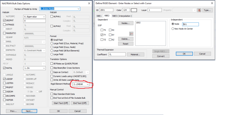

I have a problem:

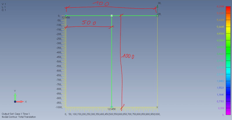

I made beam model. ( i use only a beam elements)
I would made a rigid element between elements on beams.
In rigid options i check only TY.
I used sol 401.

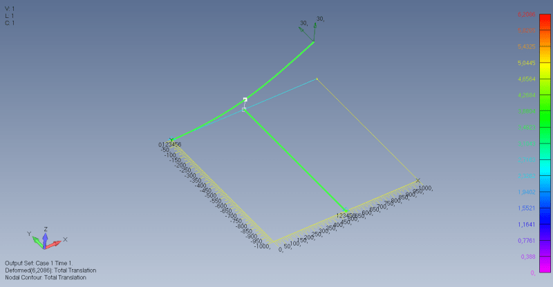

Results:
It looks like it is "Full" rigid (TX TY TZ RX RY RZ).
If I uncheck everything it still work like "full" rigid :(

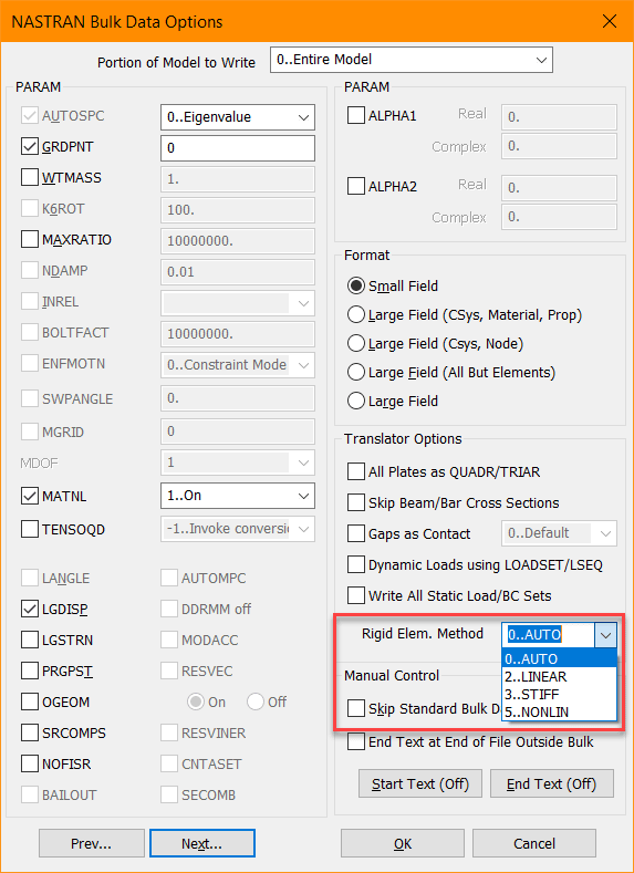

The issue is the modeling of the RBE2 with large displacements. The SOL401 RIGID=AUTO setting will select the RIGID=STIFF option when LGDISP=1. With this option, the RBE2 legs are each replaced with a stiff beam.
If you run with the RIGID=NONLIN option, the RBE2’s will be represented with nonlinear MPC’s and the solution will complete successfully, with accurate results.
