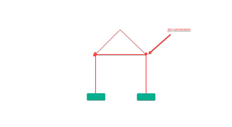

but what about all the one story houses with triangulate roof ? the connection between the wall and roof is of a pin connection. and there is no diaphragms to transfer the load to "shear wall".
if wind exerted on the roof from one side, it can theoretically make the roof collapse.
No, there absolutely are horizontal diaphragms on these structures that stabilize them via connection to the shear walls. That's precisely how they work. In some parts of the world, that's the roof sheathing. In others, it's the ceiling.

didn't know that the roof sheathing can act as a horizontal diaphragms...
I thought that, in the U.K. for example, the brick wall is assume to be fix to the ground. and than there is a static scheme for the roof.
No sir. It's quite cost prohibitive to design most building walls, and their foundations, as cantilevered systems.
