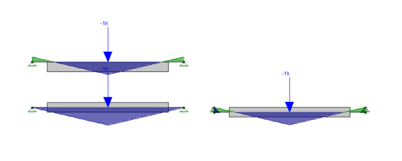

I have a problem with Risa 3d. I am not receiving the expected results. I have simply suported beam and the program is reporting end moment reactions, like it was fixed-fixed. Have you ever experienced that problem? Wha can I do? Plese see attached.
You have a top of member offset on the member, right? That effectively creates a rigid link from them members centerline to the top of the member. The boundary condition (where the pinned boundary condition exists) is at the bottom of that rigid link.
In the image below, I've modeled a simple beam with TOM offsets and without. Then I also modeled one using rigid links instead of the TOM offset.

If you are dead-set on using the offset revise one of the supports to be a roller to release the restraint created by the offset.
