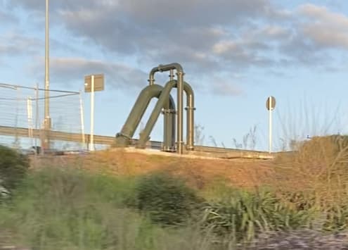

on rising mains they sometimes end by doing a vertical loop of about 10m up then down. there is a specific name for this that i found when researching pumping downhill, but now i cannot remember what it is and cant find it on google.
it has a specific term and i seem to remeber it being named after someone, like faraday loop (but not this). Can anyone help
It is definitely not a common practice. It was something i cam across when i was looking at a pumped siphon system, but as it was not what i was looking for i didn't read about it. I have just seen one in real life and wanted to know why thy used it, but cant find it. Will take a photo of it and post it. May make it clearer
Here are some photos as i drove by. the photo's are from the road and the pipes are at the top of the overpass
Difficult from a photo, but looks a bit like an anti surge device which allows air into the pipe when it stops but retains a minimum head in the pipe so preventing the pipe from emptying and giving the pumps something to pump against.

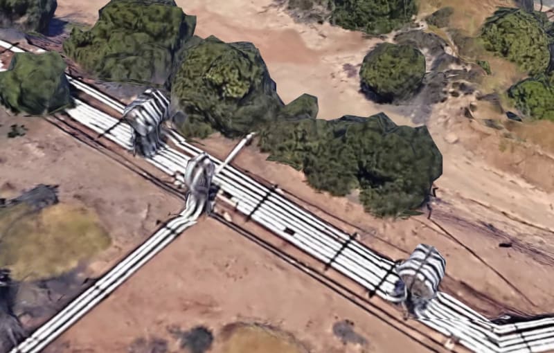

They are vertical expansion loops. If you have a lot of similar sized pipes then vertical loops are used. I don't think anyone would do work in a section between loops without clearing the whole section.
To add to LittleInch's comment, the device will also eliminate siphoning when the piping is installed over a high point in the pipeline.

Makes sense, I assume the smaller pipe connected to the top of both pipes is connected to an air valve or air vent then?

I think this one is more accurate in that the whole idea is that you don't have a vacuum valve to let air in, you just let the water itself create a vacuum which cannot create a syphon.
It would though rely on the normal settle out pressure of the pipe on the upstream side being essentially atmospheric pressure or you would need to add the incoming head to the 35ft / 10m of the loop height.
It is a pretty cheap and simple way to prevent a line draining flat without using valves etc, but then you have a rather high loop to build...
