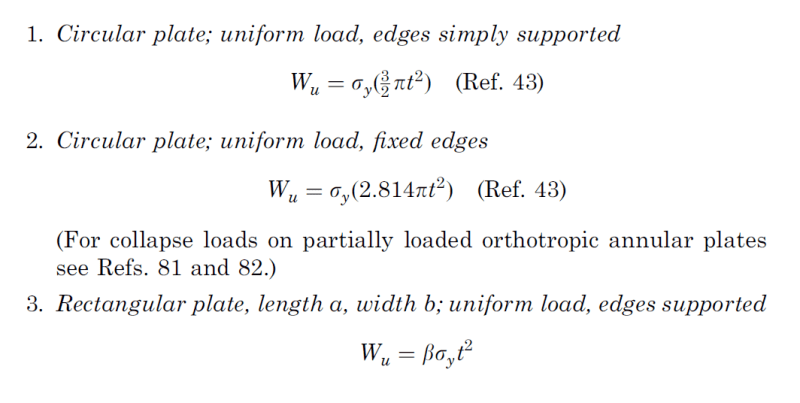

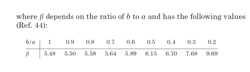

i looked at section 11.13. for rectangular plates it has the following formula for the load to induce collapse.
I understand from the table that I could go to a load more than the elastic load by a factor of at least 5 before collapsing if my plate is ductile. is my understanding correct?
By that logic, I could use a lower thickness of the plate and then check the load I get using the formulas. If the new load is less than 5times the old load (with a higher plate thickness), then my plate would not collapse.
Do you think it's a safe assumption?
I would compare stress from the table with ASD loading. If you choose to use the collapse load as the nominal strength then perhaps LRFD is more appropriate.
