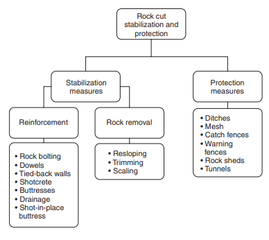

I've recently been commissioned to carry out the geotechnical investigations and remedial design of engineering solutions for a rock-slide which now places a structure at risk.
The situation is that a major office block development was built approximately 10 years ago to encroach within 7' of an abandoned quarry highwall (near-vertical cliff face, estimated height 100'). The face of this quarry highwall has recently spalled off, detaching along a joint set parallel to its crest, which has led to tension cracks opening up in the asphalt immediately behind the highwall. The nearest structural columns are just 7' behind the highwall crest and about 4' behind the nearest tension cracks. Columns are undoubtedly supported on bases bearing onto rock.
I attach two photographs showing the situation- an elevation of the failed highwall and a profile immediately behind its face showing the existing columns. The tension cracks are located intermittently between the existing columns and the top of the highwall (which coincides with the boundary fence-line). The cracks are not particularly wide at this stage, but run perfectly parallel to the crest of the failed highwall, suggesting to me that a further joint set has opened up behind the face.
The bedrock geology is Tillite- it is well jointed but has no bedding to speak of.
I'm contemplating the best investigation methodology to use in this instance, and also the kind of engineering solution that might be required to stabilize the rock face, assuming the current failure has opened up a further joint set immediately behind the face. I was leaning toward a drone inspection of the highwall face, perhaps supplemented by orientated triple-tube core boreholes through the existing asphalt at the crest of the highwall.
Practically, I'm wondering how one might go about anchoring such a rock face beneath the structure. I have yet to inspect the site myself, but I foresee all sorts of challenges to the investigation, design and construction.
Any guidance, opinions or similar experiences would be most welcome.

Given the proximity of the building to the edge of the drop off I don't think the solution will allow for slope flattening. So your left with reinforcement probably with rock bolt anchors. You can either pepper the existing slope based on rock quality or you can implement a monitoring system to find where the slope is moving to target reinforcement.
For newer open pits they are using a ground based lidar system to generate a heat map of where the movement is happening. They measure the rate and acceleration to predict rockfall. The older way was a prism based system with manual checks.
The lidar systems are very pricey and take time to detect movement which may not be occurring yet on some parts of the quarry wall, so you may be better off to do an assessment of the rock and just pepper the entire slope with anchors.

Some sort of rockbolting in the very near future is a no brainer. IMO, the owner should be informed that immediate remedial action is necessary. Any delay due to procrastination or desire to monitor , in order to evaluate how bad the problem is , can only lead to further problems.
Too many people think of rock bolting as a procedure that can be implemented once movemement is observed. In fact its best usage is to reinforce the rock mass before movement takes place.
A cost comparison between rockbolting and the financial loss to be incurred if the buildings are lost might help focus the owners attention
Who approved that site plan, and where is the pre-development stability report? The immediate requirement is rock-bolting the long term requirement is to determine if there is a risk of a larger wedge or planar failure. This will require drilling to determine which other reinforcement measure would be required in the long term.
EDIT In terms of investigation techniques for mapping the discontinuities you will probably be best doing photography from the base access road and have a long spool measuring tape sent down over the slope. For investigating larger failure planes standard core logging using the RMR system would be needed. The best book I have seen on this subject is Hoek and Bray's Rock Slope Engineering and subsequent editions.

Additional comments for consideration. From the photos, I would suggest that the vertical rock face in question is not a natural surface. Look at the faces at either extremity. To me this has all the characteristics of an old quarry. If correct, this might have contributed to the erroneous idea that this
is a stable face.
Look at the vegetation growing out of the rock face just below the affected building. Compare this with the complete lack of vegetation further along. The existing vegetation can only contribute to instability.
rock bolting the face in a conventional manner is certainly worthy of evaluation but there is another option. Using the face height of 100 feet as a reference, it may be feasible to cable bolt the entire rock mass with drills set up behind the upper road. This eliminates the need for the expensive crane and allows the drillers to work with both feet on the ground..... a major improvement in manpower efficiency.
If mapping can identify the most unstable areas, cable bolting could be focussed on those areas , rather than the expense of large scale area bolting
