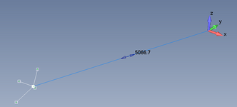

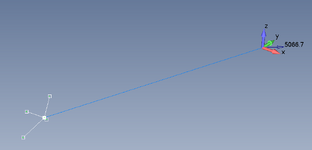

Hi Everyone, i have a model with rod element, one end connected to the structure and the other end of the rod is fixe. when the solution is run, i get the rod Force and the resultant at the constraint same. but i dont understand why the resultant vector on the fixed end do not align along the rod axial direction. can anyone tell me the reason for it ? Thank you in advance 1742310516102.png1742310547072.png
is the nodal coordinate system aligned with the rod axis?
nope its not aligned , its oriented w.r.t to global. whether its local or global , i was expecting the resulting force vector to be along the rod axial direction since there is not component. What am i missing in this interpretation ? . THanks SWcomposites for your response
it could be a plotting issue, or a coordinate system issue.
have you checked the actual nodal force components?
you are using FEMAP, what solution code are you using - Nastran?

i changed multiple CSYS, there is no effect in the direction it is plotting the resultant. I am using FEMAP simcenter Nastran for SOL

One thing is the resultant internal axial force, and another the reaction forces at the constrained end, this is dependent of the applied loads to the structure.

Hey Blas, thank you for your response, you are right my reactions are aligned with respect to the applied load. So it does not necessarily have to be aligned along the rod axial, unless the applied load is actually along the rod axial. Thank you for turning the bulb on inside my brain. Cheers !
I too think it is a plotting issue. To confirm, create a CID aligned to the rod, output the ROD results in this CID. If it is a ROD, then the force is axial ... Has to be.
