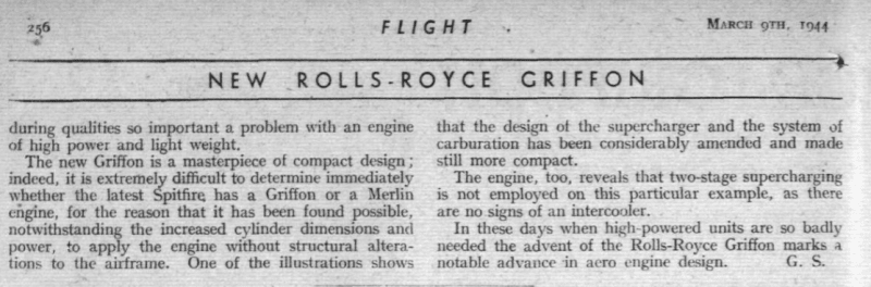

also Neville Shute's autobiography. He worked for RR on the merlin, improved the supercharger.
Also R engine is not related to the later Griffon offshoot of the Merlin … at least according to wiki.
There was a "Griffon" R engine development.
