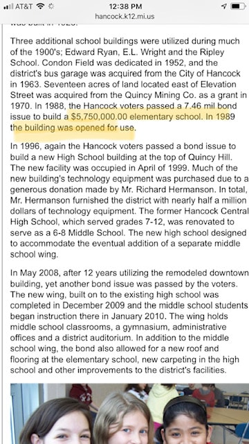

One thing that I haven't heard or read anywhere, is how old the building was. It looks fairly new but there's no mention whatsoever when the building was constructed. I have some contacts at the university and I'll inquire and if I hear anything I'll post it.

I heard from a couple of my contacts at the university and one of them (who was my statics and dynamics instructor back in the day) provided me with info that showed that this school building was opened in 1989, so it appears to be a 30 year old roof system.

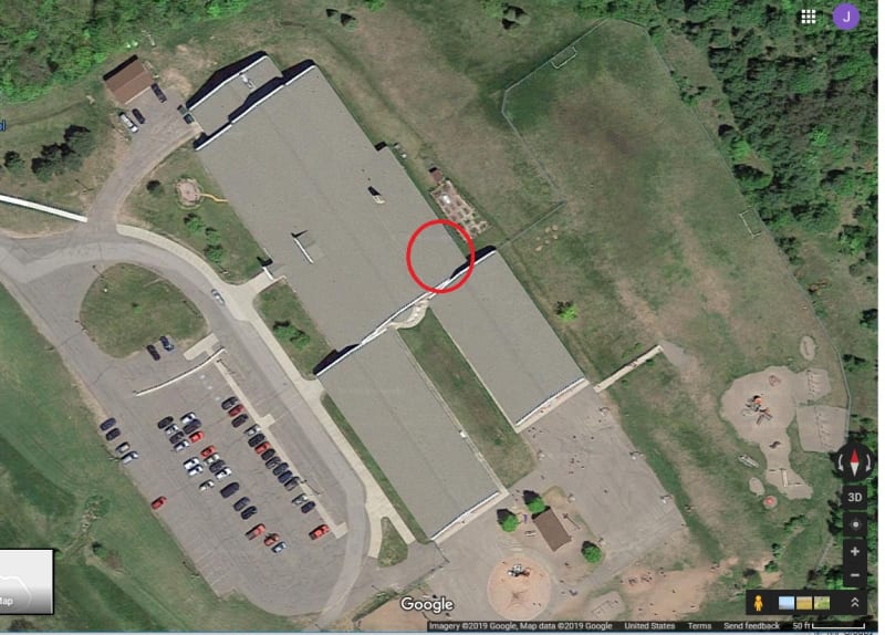

Given the average snow fall there, it seems pretty crazy that this lasted as long as it did with these apparent defects in the roof trusses. I wish more explanation was available as to what the exact defects were. Based on the video in the link above and the pic attached, looks like an area for snow drift.

I was at the school board meeting the Daily Mining Gazette article about defective trusses was based on. Strangely the article does not make clear one thing the OHM engineer told us -- that the school board and school administration were aware beforehand that the trusses were defective. In fact OHM already had plans drawn up to correct the defects, but were waiting until the end of the school year to start the work. Yet the school administration was making no special effort to keep snow off the roof this winter, especially the rear roof. Look at the photos in the Keweenaw Report article in the first link. Note the difference between the snow piles on the ground at the front of the building (heaped as high as the roof eaves) and the snow pile at the rear of the building (more of a drift than a "pile" and half the windows showing). If you do a Google image search for "Barkell snow roof" you can see larger versions of the same photos.
If I sound a bit mad, it is because my 6 year old daughter goes to that school and was under that roof every day. It was an actual classroom that caved in, one that would have been full of kids 8 hours later, and there are/were more defective trusses in other parts of the building too.
