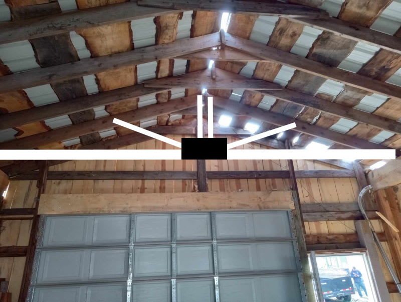

I have client who needs to bring this roof structure up to code. He would rather add rafter ties than lift the roof and add a ridge beam (26 ft length - required a 3.5in by 16in deep LVL, which was a no-go for him). I just thought I'd post this here and see what you guys thought. I guess we will add some verticals and rafter ties and attempt to convert these into trusses, along with a few horizontals between the rafters. But this is nuts. He really needs to just rebuild, but that seems like a lazy engineering solution. Do you guys have anything to help with stability here? Picture is worth a 1000 words. The roof is 24 ft across, the current rafters are 2x8 at 24in o.c. Snow load is 35 psf, so we (with the ridge beam, treating these guys like bending members) were going to be sistering additional 2x8s as well. I don't think that is still necessary if they do have truss action. Slope is approx 3-4:12.

It's going to be interesting trying to get these pieces and parts and connections to work via analytical methods. You could maybe get the rafters to work via the code if you add purlins and purlin braces, but the ceiling joist won't have the interior bearing wall you want it to sit on. So the purlin brace is engineered and that force will be large and difficult to transfer. You've also got the wind loads to contend with.
There are a lot of houses with that same type of construction. Rafters with a half-ass collar tie. Every time I see a sagging roof or leaning walls when I drive by, I immediately think that's the type of framing that caused it. I think your proposed solution is actually pretty good. You could also use a tension rod to "pull up" the roof if you've already got significant sag.

Maybe I'm being thick here but I don't see any problem with the proposed solution, assuming everything calcs out
Seems like the dead load is pretty minimal so the deflection as-built should be acceptable
You're then adding in additional structure to ensure that the dead + snow case works
Putting tension ties across with hangers from the ridge seems reasonable and pretty easy to calculate out and this whole thing would be straightforward to model

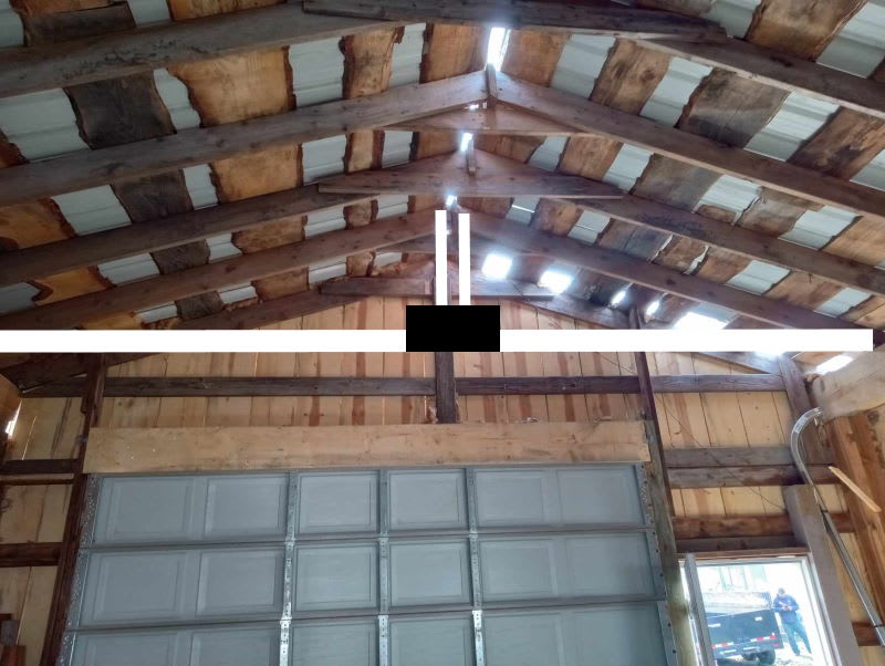

Had a similar situation about 15 years ago. A friend wanted to remove a load bearing wall running down the center of the house. For all rafters, tied the ceiling joists together and added a vertical at the center to create king post trusses. Still working as expected.
Adapting that to your situation would be pretty much what you described, just on a larger scale:
To upgrade load carrying capacity of the existing rafters, create queen post trusses:
Thank you all so much. Nope, no ceiling running through, for lateral, it's essentially heavy timber construction, client has 9x6 posts connected to 10x4 beams. We're adding 4x4 knee braces every 8-ish ft, thinking the 10x4 beam and bracing will be adequate for this single story (about 4 kip per wall or about 1kip per post/beam connection for seismic). I wasn't counting on the roof to resist any seismic/wind load. The walls are very sturdy.
Might be easiest to just add new trusses between the existing rafters as mentioned above.
Is the roof showing signs of deflection and distress?
Are the eaves beams absolutely massive to prevent roof spread?
Not saying you shouldn't bring it up to code but you would expect either distress or there to be a legitimate load path.
