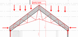

Hello,
I am wondering if there is a way to utilize wood trusses like in the picture below. The owners do not want ceiling joists and for the sake of the discussion, let's say that a ridge beam is not an option (the span would be over 35 feet). I am worried about the thrust, as once I tie the trusses down to the walls it will create a horizontal pin at each wall. Does anyone have a suggestion on what to do in such a situation? Maybe a bracket that allows for lateral movement?
Usually we get the truss supplier to design around it being pin-roller, but keep the lateral deflection to 1/2". Then just assume the walls are flexible enough to accommodate 1/4" each at the top of the wall, which is generally tolerable.
Thanks for the replies. So, the truss supplier will keep the deflection to 1/2" and the EOR assumes that the walls will not resist lateral loads at the top?
What would you recommend to do for the wall lateral deflection due to wind? The shear walls will be approx. 35ft apart. See below.
35 feet isn't that far for the roof plywood to act like a folded plate diaphragm. The detailing is a bit onerous if you truly want to get everything to calc out. But it's done fairly regularly.
I think what @jayrod12 and @SinStrucEng are saying is to fasten the scissor trusses at each wall with a pinned connection, and checking the walls for additional stresses due to 1/4" of outward deflection from the thrust. This allows you to use the roof structure to brace the top of the walls and transfer wall pressures to the roof diaphragm.

What would you recommend to pin the truss to the wall? I usually go with H2.5A ties plus blocking in between trusses, or a35 angles.

As long as that calcs out for your uplift, and lateral loads, I see no issue there.

As been discussed in many previous threads, I don't think anyone in wood construction does this. What do you do when you get near the corner?
I've read some of the old threads, seems like many are against the slip connectors that are intended to relieve the thrust, the other option is a horizontally restrained connection (i.e. pin).
What's your concern at the corner? Perpendicular wall stopping the bearing walls from deflecting outward? I haven't had issue with this but maybe you could use those slip connectors for a couple feet near corners to relieve the thrust. Or maybe try to enforce making the connection after the dead load is applied, although this seems very unlikely to happen.
What do you do?
I pretend the corner isn't that stiff to be completely honest. Often with scissor trusses like those shown, I frame a full height wall and the first truss doesn't start until 2 feet in from the corner. so there is already some flexibility in the wall system by the time you get to the first truss.
When it is just a truss at the outside, there's still often a wall framed tight to the underside, so now it's a gable truss that doesn't need the pin-roller support conditions and therefore again, the first truss needing some flexibility in the walls is 2 feet from the corner and likely there's enough movement there.
Although I'm generally not a fan of this next statement, and please everyone don't bother pointing out how "dangerous" the coming thought is because I've heard it enough, this type of detailing has been done forever without issues that I've been made aware of. I'm yet to see a bottom chord of a scissor truss buckle laterally because it is now in compression because the walls weren't flexible enough to produce a pin-roller support. If someone has evidence of that failure mode, I would love to see it so I can adjust my mentality going forward.
Regarding the slip connectors, they end up not working anyway. Between the roof plywood being fastened to blocking that is in turn fastened to the top of wall rigidly, and the interior finishes on the trusses, you won't ever see those things actually move. and if you did, you'd be constantly having to repair your drywall joint or the exterior finishes as the trusses move in-out. It just doesn't happen.
The bottom line is if you keep the spread reasonable, it just works. As you near the corner the roof diaphragm does a bunch of folded plate stuff to reduce the spread.

I have seen several buildings with significant issues relating to "spread" or horizontal deflection, but these were the exception not the rule. In most cases there was indication of underdesign of the scissor trusses (lack of snow drift consideration or similar) along with a lack of common "secondary" mechanisms that we do not specifically count on but may limit the horizontal deflection.
There have been multiple posts on here regarding reasonable methods to justify the thrust deflection at the heel and practical limits proposed. I do not recommend ignoring the horizontal deflection or neglecting it without some thought, but if the theoretical horizontal deflection is limited to some small value (maybe in the range of 1/2 of what you would allow a wall of that height to drift or deflect under wind loads) the roof and wall system has historically performed pretty well. In practice you should generally see less thrust than this theoretical horizontal deflections presented in truss calcs due to the "secondary" mechanisms I referenced above, some of which are mentioned in other reply. Much more information can be found in past posts on the topic.
I would recommend looking at the window and door headers to check for deflection laterally. If the truss is stiff enough there should be limited thrust. Most of my clients refuse to use truss roof systems.
As others have noted above, I can't see a slip connector working. Even if it worked perfectly, though, with no horizontal force being transferred between the top of wall and roof, then you'd have a new problem because there wouldn't be any restraint at the top of the wall for out-of-plane wind/seismic forces.
Typically we do a pin on one end and a slip, with an actual slip connection clip - something like the Simpson TC, the opposite and alternate every other truss. This way you do have a pin for the wall/diaphragm connection and you have a slip the opposite end.
