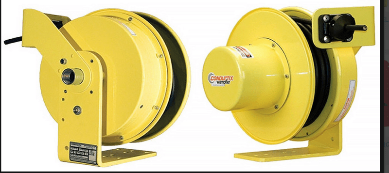

If you want torque use a torque motor.
This is a motor designed so that it is able to withstand locked rotor current indefinitely.
Torque motors are often use on cable take-up reels rather than a spring.
I remember one reel with a torque motor that retrieved or laid down about 600 feet of feed cable to a moving bridge crane.
The cable was about 1 inch in diameter. Try that with a spring type take-up reel.
Wound rotor motors may be used as torque motors with a suitable high resistance in the rotor circuit.
An advantage of the wound rotor motor is that the torque may be adjusted by varying the rotor resistance.
At slow speeds the torque motor will develop torque in the chosen direction regardless of the direction of rotation of the driven machine.

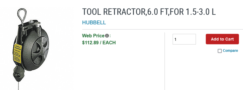

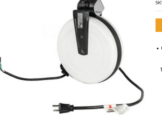

Sorry could you clarify what you mean by using a torque motor with a spring type take up reel?
Small take-up reels use a spring.
Applications too demanding for a spring use a torque motor.
Some spring driven reels:
Electric Models
Larger reels are often custom designed and built.
Some use a gear box or chain drive between the torque motor and the driven element.

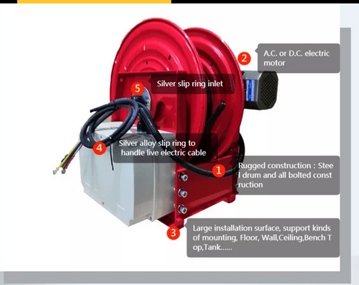

A large motorized cable reel for a port crane application. Old school often used magnetic or hydraulic torque converters. Now they tend to use VFD's and motors rated for continuous zero speed operation.
