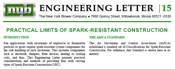

I want to design a centrifugal fan for transporting wood dust. Is there any rule of thumb or technical standard for industrial fan? For example, size of hub, blade thickness, shaft diameter, materials etc.

Thé book Fan Engineering published by Buffalo Forge, now Howden, has some good information. Engineering Letters by New York Blower NYB.com also may be helpful.

I agree. Wood dust is like a combustible gas. A little spark would create fire or explosion. For example metal-on-metal contact at high speed.

Check out AMCA, also.
Spark-resistant fans are not uncommon.
