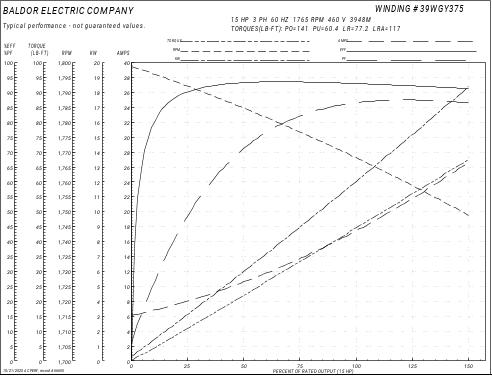

My boss here at our plant (Maintenance manager) was challenging me yesterday saying that a motor runs best when ran AT it's FLA, vs running it a bit under, say at like 80% of its FLA. I felt that is wrong, but can't find any data to back it up. Can anyone help on this topic?
Some considerations:
1) More amps mean more (I**2)R losses
2) If higher amps produces higher speeds then there would be more air losses.
Do some googling of motor efficiency curves.
You may find that the peak efficiency of most motors is around 70% to 80%.
Bill
"Why not the best?"
Jimmy Carter
THIS GRAPHIC SHOWS TWO THINGS.
1> The efficiency of this typical motor peaks at about 75%.
2> The efficiency curve above about 40% loading is quite flat. You only drop about 1/2 of a percentage point from 75% load to 100% load.
Bill

Looking at just the motor efficiency though (because yes, what it is driving is more important), there were several studies done by the Dept. of Energy years ago, resulting in programs to increase efficiency in electric motors. This paper, geared toward energy efficient motors, corroborates the other information about the peak efficiency being around 75-80% load, but you are really splitting hairs because at 100% load it's only off by a small fraction.
Look at the chart on the top of the page in Chapter 4 page 13.
But also notice that a 1HP motor does NOT follow that rule.

As others have said, the motor efficiency peaks around 75% to 85% of rated load depending on the motor design and the rated load efficiency falls off slightly.
